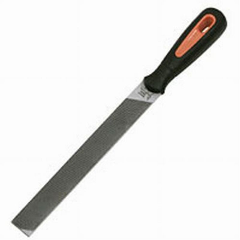

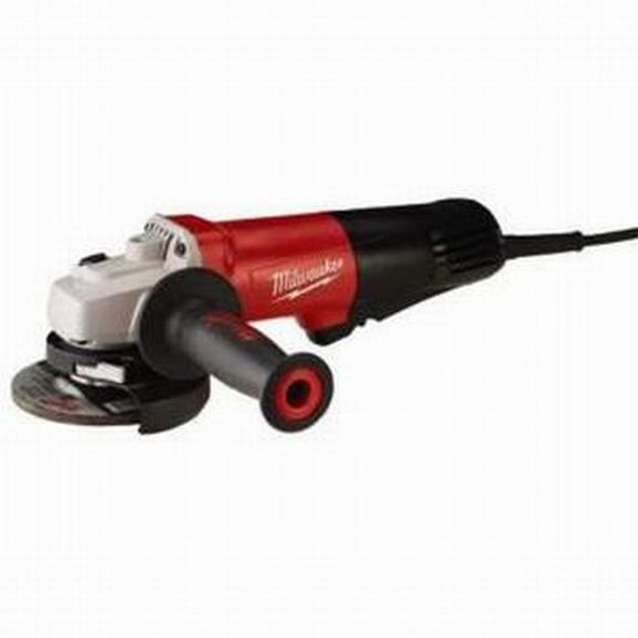

Seriously though. Blindly attacking it with a file or angle grinder is a HORRIBLE idea.... a belt sander would at least assure you of a more even surface. I'd attack it with a lapping plate with a piece of 320 sandpaper laminated to it and then some diamond lapping compound of decreasing grits to take it down (In fact I've had to do so in the past).
