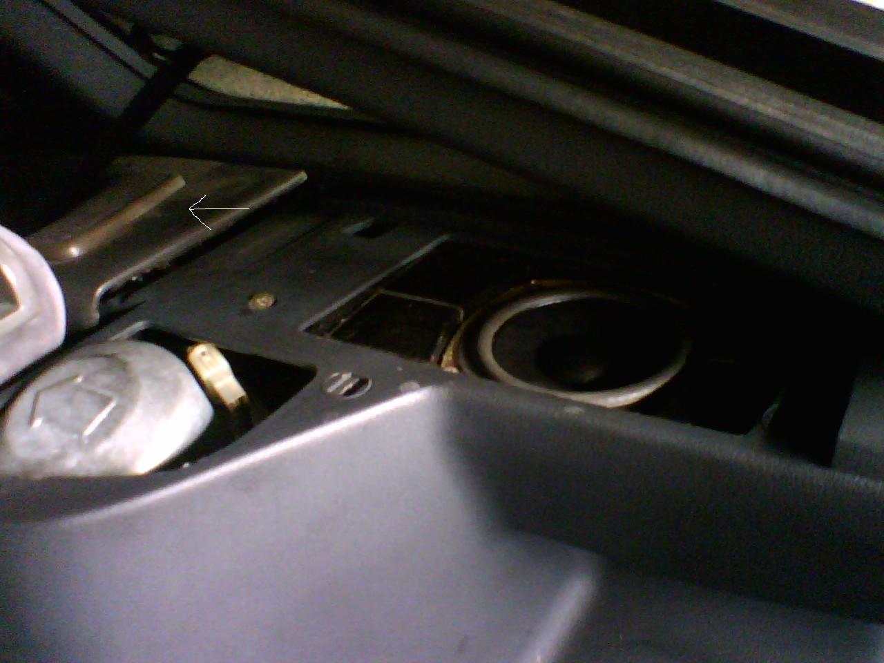

Not the best picture but you can see the stock 4.5 inch sub in the boot, the 3.5 inch speakers are at the top corners of the back seats right in front of these.
You'll need to remove the back seat in order to remove the side panels so you can get your hands on them.
