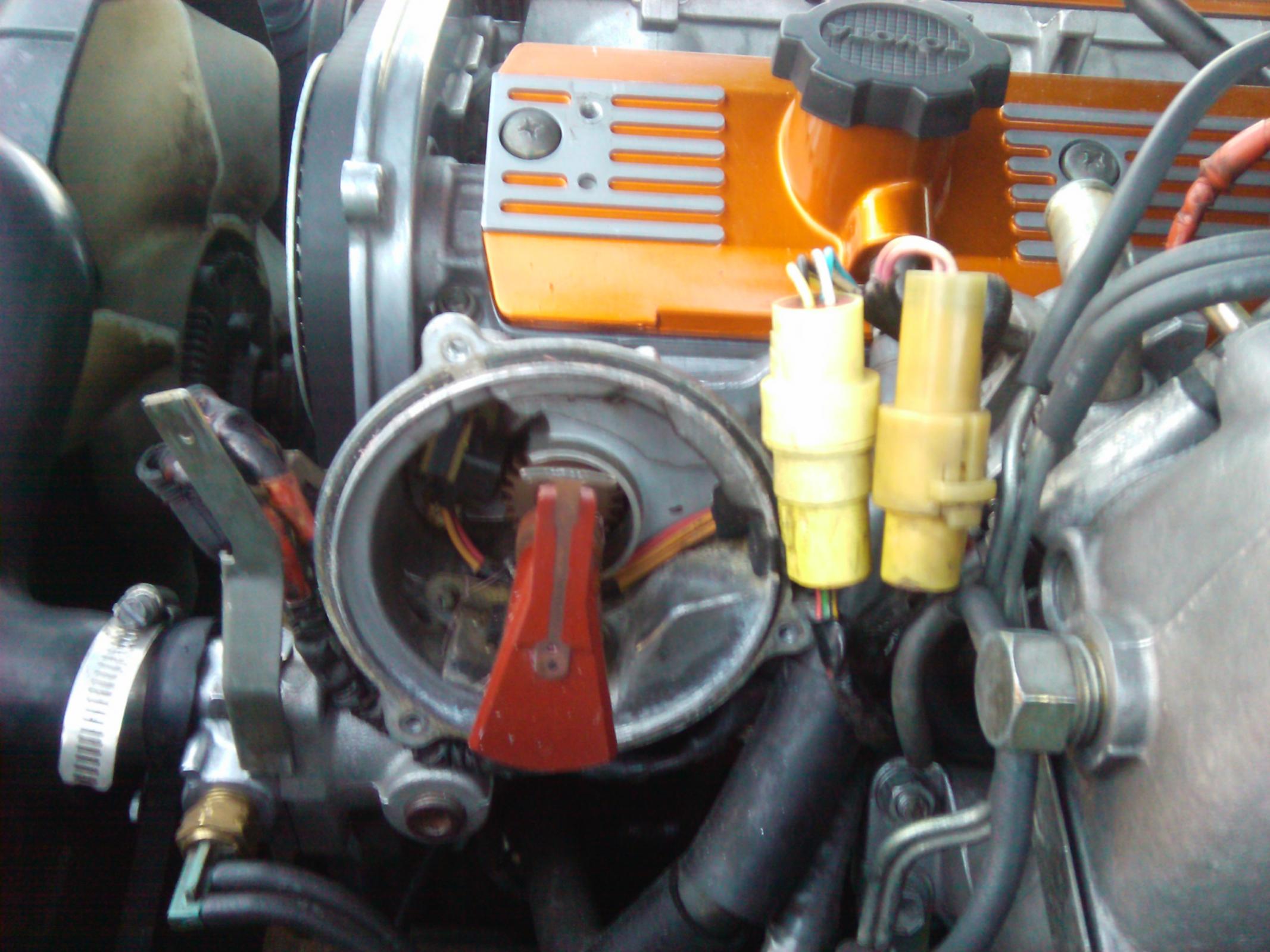

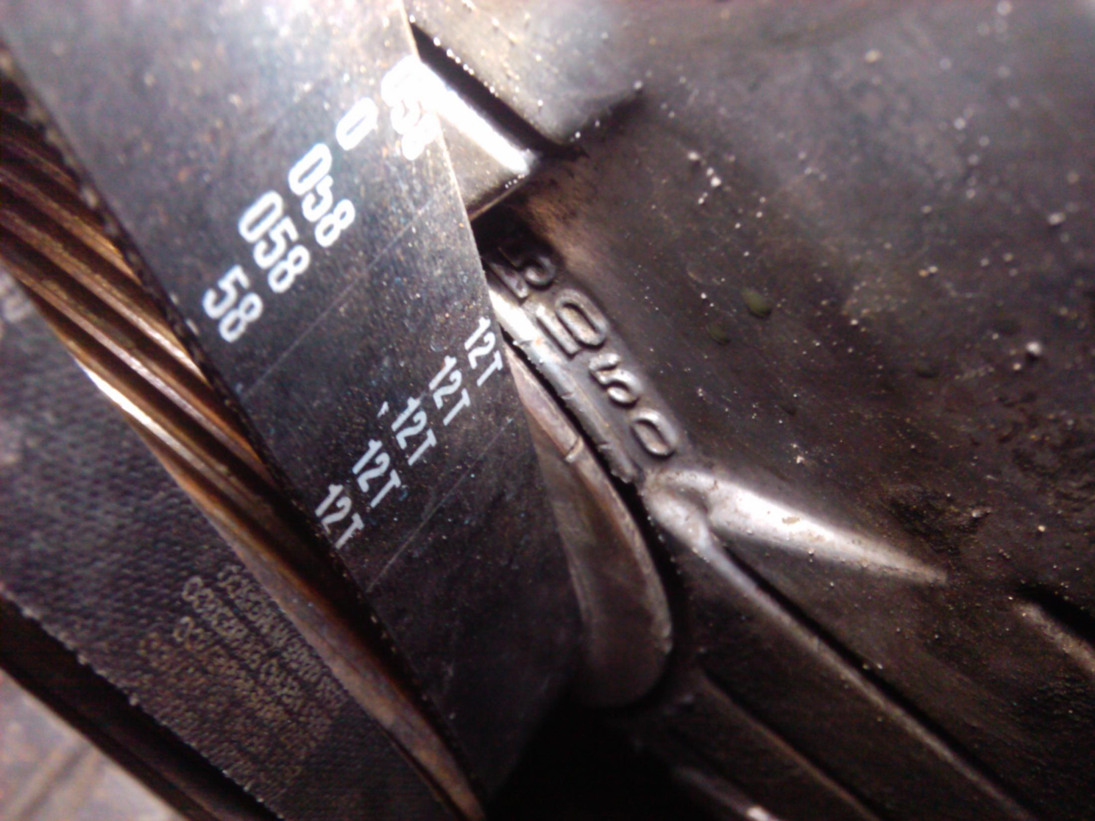

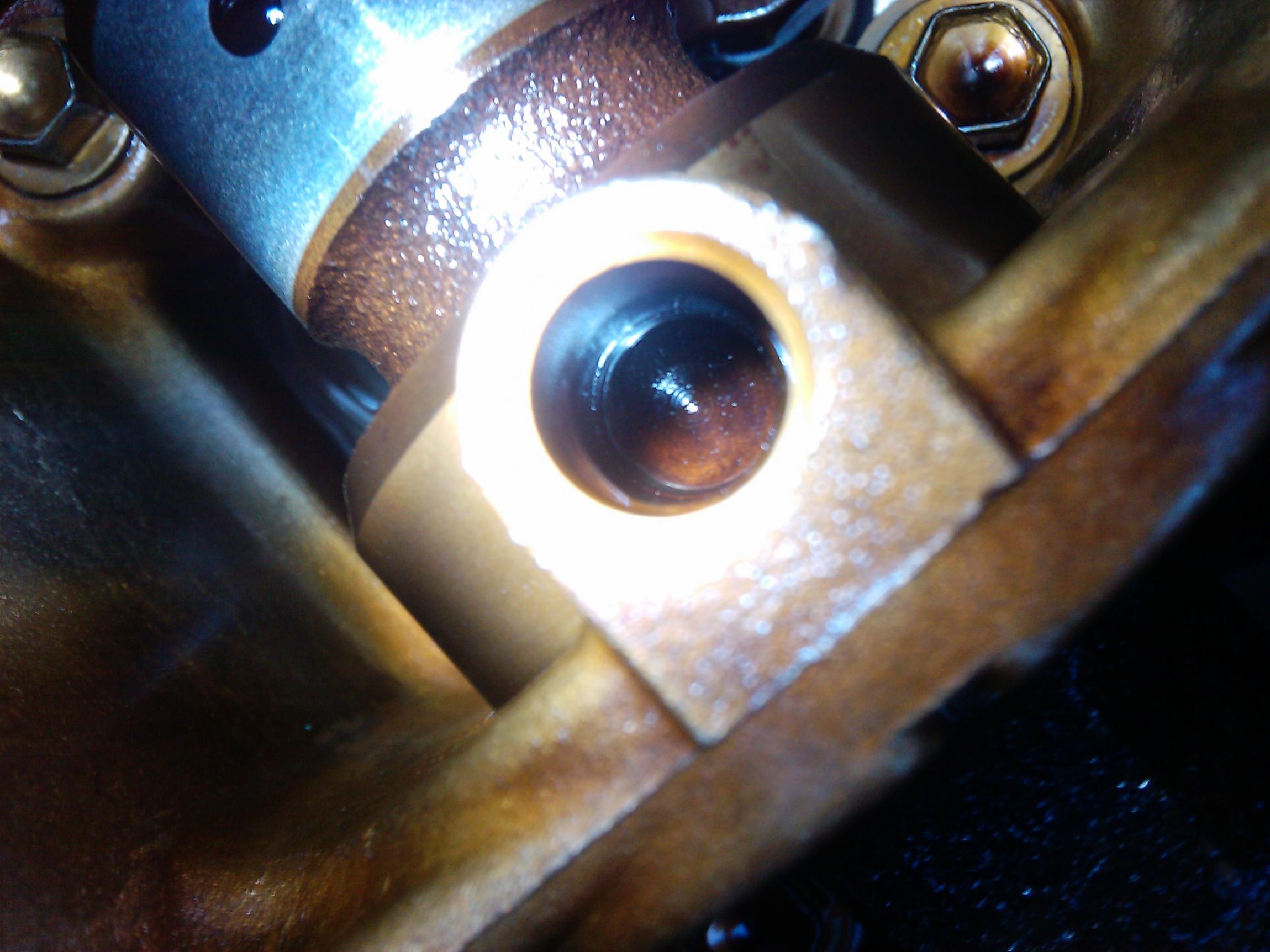

Here's some pics:

intake cam

exhaust cam

dizzy
Crank timing
I pull the timing belt back off and made sure everything was perfect with its timing marks but I noticed I couldn't get the timing belt on then.
Old 09-19-2012, 03:59 AM   #113
mechrider89
Join Date: Feb 2011
Location: Saskatchewan Canada
Posts: 117
Blog Entries: 1
Ok well I found my dizzy was 180 degrees out so I flipped that around and turned the key.......VROOM! it started has a little cough and stutter at the start every time but after that she has a steady idle and responds well to throttle. But of course there's bad news I'm hoping my valve aren't hitting my piston on one of the cylinders and its just lifter tick but I'm very worried. I checked the timing another 2 times and its good all around this time tho.......hmmm

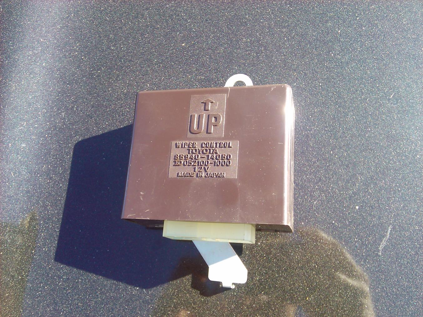

Hey and bak'in wondering if you have a wiper control unit laying around?

i can take a look around. do you have a picture?

Here's a pic of the wiper control module. should be brown like this:
Its located passenger side kick panel by the door and hidden behind another yellow control module.

ill take a look around, but i am getting a parts supra, so if you have not gotten one by then, i will have one for you.
