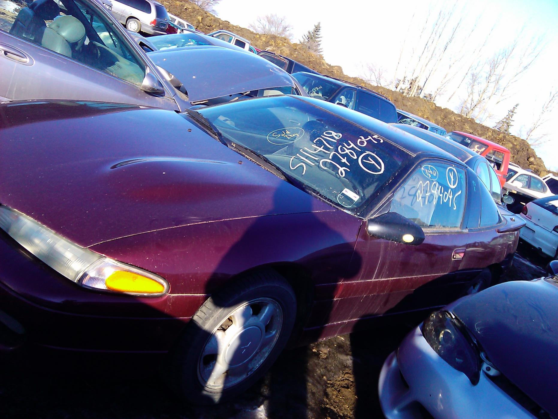

Well little bit of an update, winters here and all I've basically got done is the hood primed and ready for repainting, and new wiper linkages that have yet to go in. Its 25 below here so my work is done for awhile seeing as I dont have a garage to work in. Hopefully be getting new stainless steel slotted rotors for Christmas just have to go back to the local shop and decide which ones I want. Found out my head gasket or head might be fucked, lots of moister coming out around the head and steam so I'll be looking at a new head gasket at the lest and my hatch is completely toasted rusted right through on the inside in several places so I some how need to afford a new hatch along with a full body paint after I tear her right down, plus hopefully only a head gasket. Another thing is I bought a 92 eclipse just this weekend for a steal from an auto wrecker, I'm a huge DSM fan so I'll be working on it first just needs a couple things and it'll be my DD till I fix my supra then the supra will be the DD and I'll be doing a rebuild on the Eclipse, if I can get all the parts I'll be swapping the 4G63 n/t for a 4G63 turbo set up which will give me (when I'm done) roughly 240whp (will get the head ported and polished, can also get a good aftermarket head gasket with upgraded 450cc injectors and a walbro 190lp) from the 135whp I have now; that's only if I can get a good turbo tranny from a GST model. The reason I'm putting the supra on hold is because the Eclipse is going to be the fastest build right now, I hope you guys aren't to mad. The supra will be worked on just not for awhile sadly. :-( I'll keep popping in from time to time to see whats up and if you guys want to still know how its going then I'll update here as well as on DSMtuners.com. Thanks for all of your guys get advise and wisdom I'll still need it and am always looking for more.

The Eclipse I bought

still interested myself in the supra build, and cant blame ya for pickin up an eclipse. been seriously lookin at gettin a gsx myself, just for shits n giggles.
i thought the 1g eclipse N/A motor was a 4g37? ive seen a few n/a 4g63's, but in 2g's. idk, shows how far my knowledge on dsm's is.
good luck with the build tho, driven a few GST's and they are hard to keep the tires planted in!

haha ya they are, my first DSM was a 92 talon TSI, never should have sold that car! Actually most Eclipse's/talons/lasers for the most part all came with 4G63's in them 89-93 had the 6 bolt flywheel (considered the best engine) and the 94-98 have the 7 bolt flywheels but better ECU's and turbo's for the most part, never heard of a 4G37. lol

ah nice nice. yea ive got a couple buddies over here with some decent talons and eclipses. problem is the cars are so rare and all these guys snag the good shit b4 i can get to it! haha.
the 4g37 is the 1.8l pos 4 banger they put in em. SOHC, gutless. lol.

dude if that's the cars in good shape buy it!!!!! thats a bloody steal. I got mine for $770 running and driving from a near by auto wrecker, bent valves and a head but other wise good condition car for $400 TAKE IT!
you find it online I take it? pop me a link?
Ya im not used to hearing the 4g37, but ya the 1.8l is junk.
You see the car to the right of mine in the pic's the 2G talon has a really rare factory bumper I'm going to see if its not broken and if it ain't then that'll be another $190+ in my pocket.
Oh and if you do buy it get the balance shaft eliminator kit for the engine when you rebuild it, it'll stop the timing belt from skipping on you.
here's a link:http://www.dsmparts.com/customer/pro...8&bestseller=Y
I'm jealous of your friends TSI, no one around here sells them once they get them so their very hard to find in my province. I'm stuck with a lowly eclipse gs but hey its a manual, so I cant complain to much.
