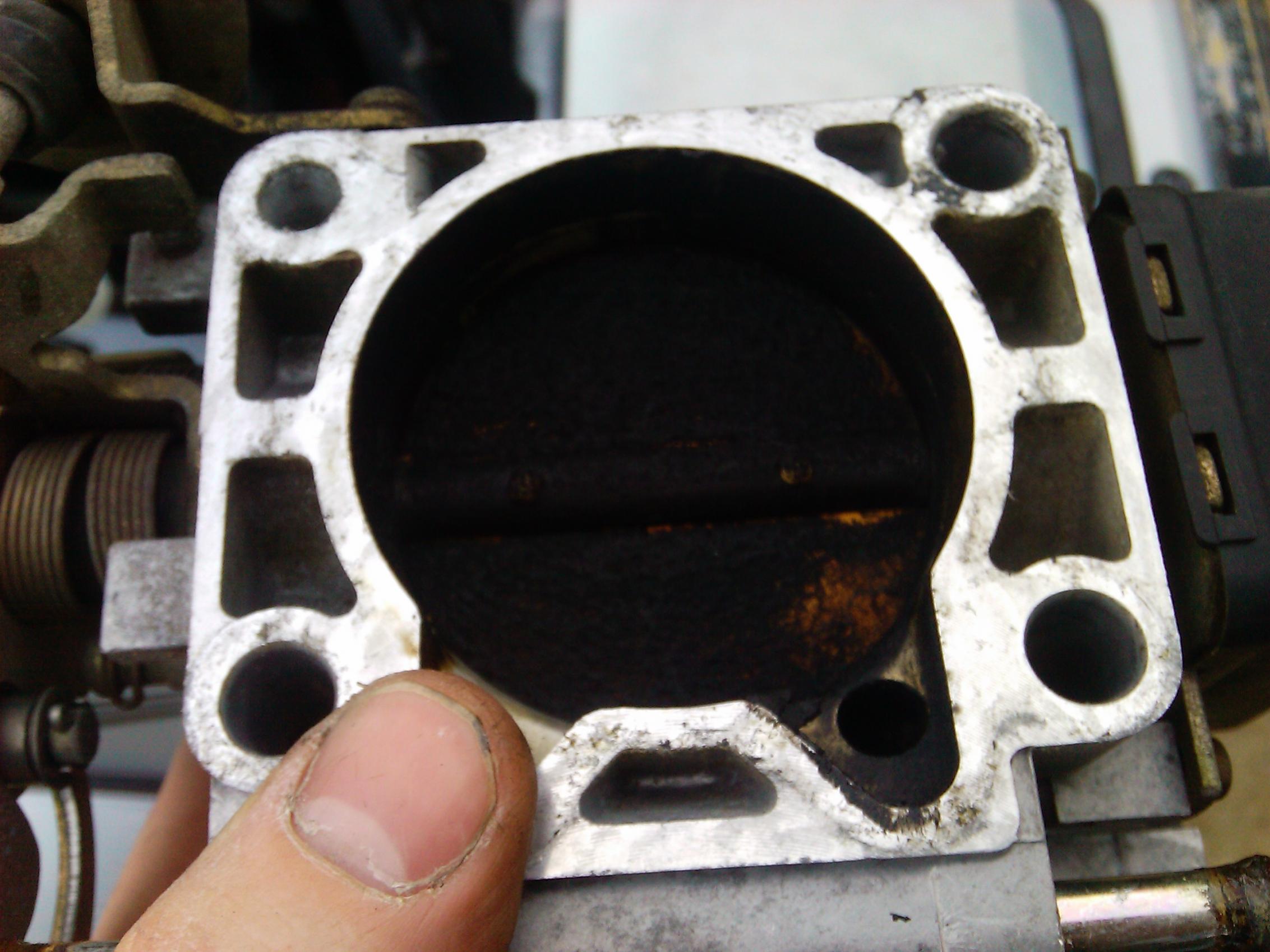

ya mine idles low as well but I think I found my problem:
My whole intake system looked like that!
plus my ignition system is in desperate need of maintenance, so that's another place to check out for your problem.
