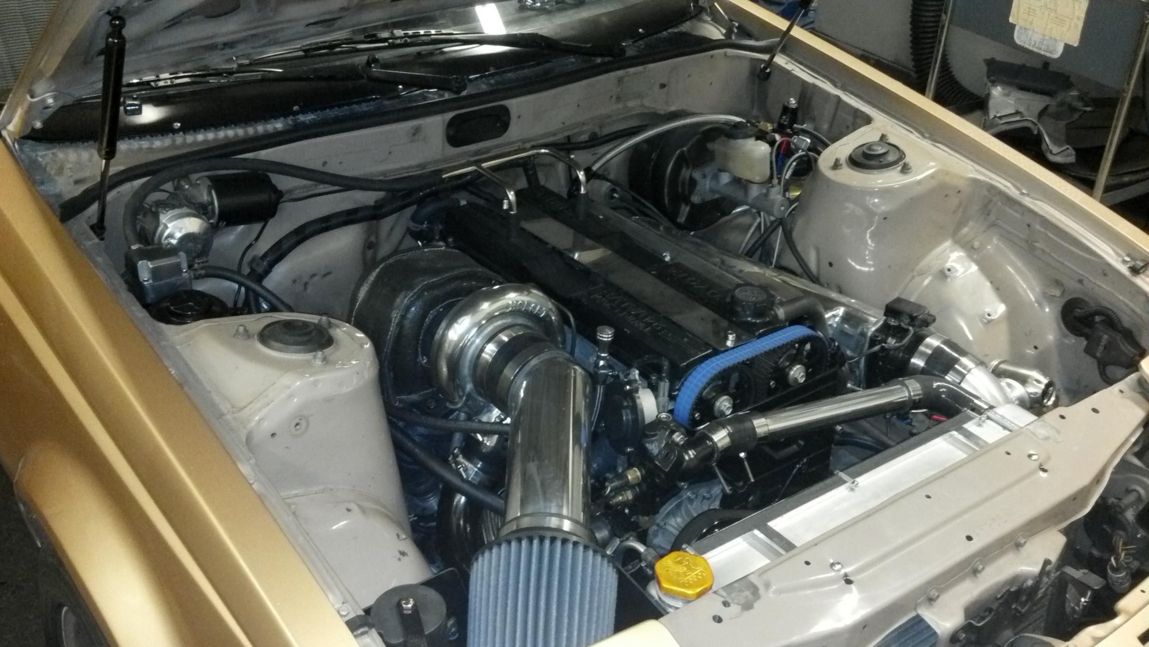

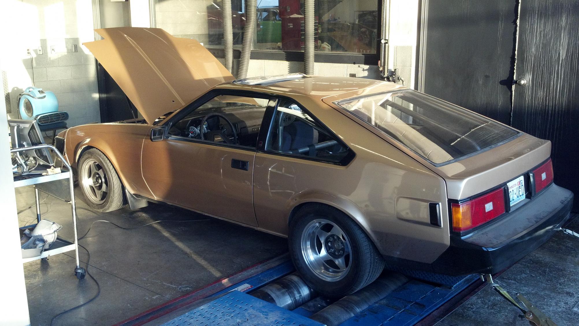

so, my buddy mike is a big supra guy. loves em, all kinds of them. currently hes got a few mkII's laying around, as well as several 7m's to throw into them.
heres his latest rendition.
heres the details: 88 7mgte block, 9.1:1 compression, custom cp pistons, carillo rods, balanced rotating assembly, PnP head, OS valves, stock cams, custom cometic HG, custom FFIM, custom top mount SS tubular turbo manifold, hybrid hx35/hx40 turbo, 3" exhaust back, 4.5" intake, built a340e auto tranny, built 8 inch straight axle out back, all running off MS3 and megashift, tuned by the man himself, mike.
if you check the dyno graph, youll see the power hes making with the minimal boost, theres alot more on tap. did i mention he also has a 250 shot of nos he hasnt done yet? enjoy
