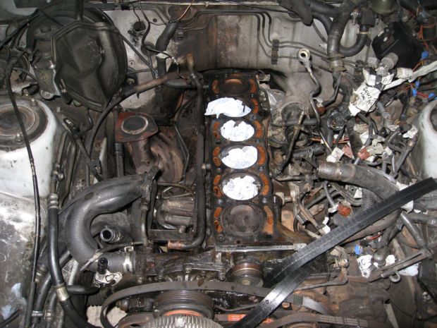

phew!! got the head off today, left the cam position sensor on but still unsure what to do with it once i remove the cams i.e timing it up?
right so now i need head bolts and a new gasket and some servicing to the head. any recommendations for parts would be helpful.
not sure how to get the valves out either or what to expect.
still im extremely pleased about getting the head off heres a few pics of todays efforts.
