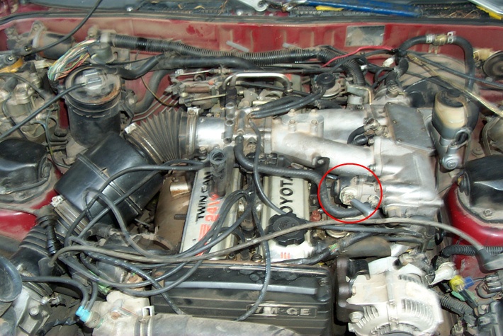

Okay, I got everything back on and started her up. Nothing!!!! I believe that the fuel pump is toast. She ran using starting fluid, but not very well. There is plenty of gas, four gallons or so I just put in. I haven't pulled a fuel line, but I believe that there won't be anything there when I do. How hard is it to change the fuel pump. Is it like every other toyota I have owned and just pull the inspection cover and yank out the old and put in the new? Do I have to drop the tank.
Also, where does this tube go. I can't find any logical place, so I must be missing something. Here is a couple of pics of the tube in question.

that hose connects to your ISCV which i circled in red. Theres a big nipple on it.
BTW make damn sure that your fuel pump is the cause of the issue before you replace it, its expensive and a lot of work (you have to pull the tank) and youd be pissed if you replaced it and it didnt make it work.

I figured that I would have to drop the tank. I am pretty sure that it is the fuel pump I will have to pull a fuel line to make sure. The last time I did that there was no fuel at the rail and there was fuel in the tank. Does the ICSV have two hoses running to it? I ask because there is already one attached to it. I will have a quick look see at lunch.
