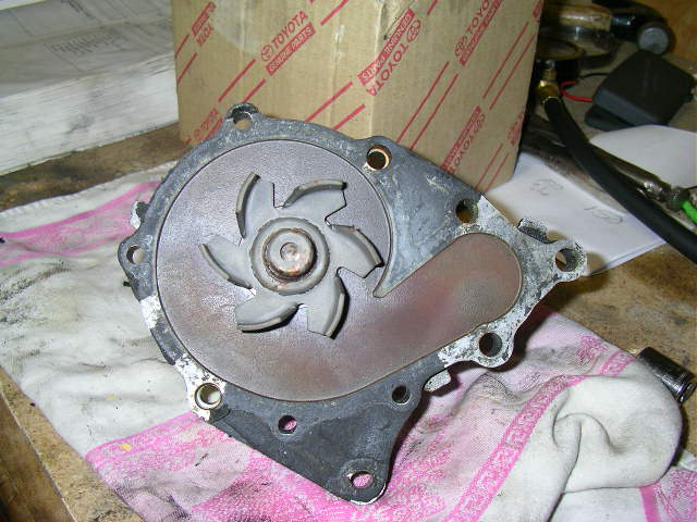

Like I said before, I don't like the impeller setup on the water pump though and thinking that it may be causing some of the bubbling in that area. I did notice a difference between makes of water pumps though. Some had deep blades while a few others were shallow. I suppose I should break down and buy the proper TOYOTA pump, $95.00 ouch!

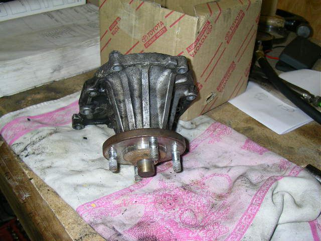

Well the waterpump pictures are appreciated. They all are the same I guess, just seems weird though. The mating surfaces on both the head and block were machined and very flat. I tried a few heads that had the water channels eaten out by electrolisis and that is where they never sealed well enough and leaked. This basically new head has no pitting nor any irregularities on the surface. It was checked before I bought it so I don't have first hand knowledge on actually seeing the checking being done.
