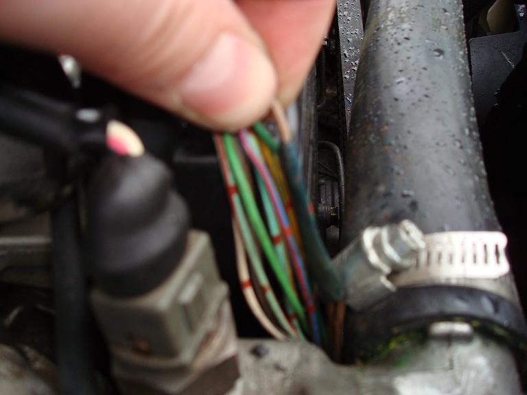

So I took a look at the wiring, and this is what I found.
The camera wouldn't really focus properly, but the yellow wire is bare at the beginning of the connector in this pic :

Yea that looks a little dodgy man if you really want to you could change the looms or take it down to an auto sparky and get them to have a look

Yeah, I would check the wiring on your parts car's MAF sensor plug. Wire colors will probably be the same, and if so I would cut the connector off of it and splice it onto the Supra you're trying to get running. I'm pretty sure those 2 wires shouldn't be spliced together, but I can't say for sure as I don't have a N/A that I can easily go check the wiring on...
