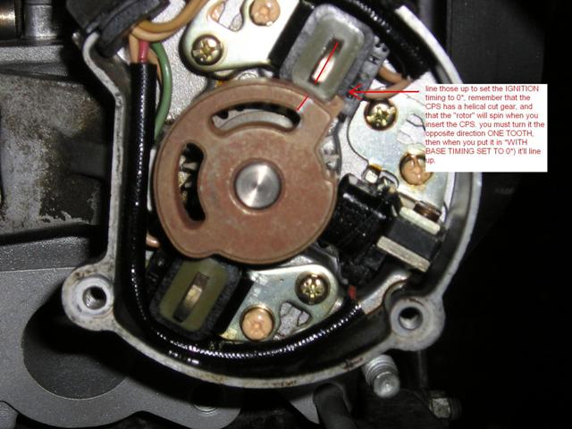

hey arent wire 1 and 6 the same anyway? does it matter which one i hook up?
also.. i did that.. lined up both cam to tdc and the crank at 0*
then made the cps look like this
(photo curtousy of saeff from sm)

That's what I thought, but the TSRM says to use no. 6 so I figure that'd be the best route.
I never aligned the cps with the cover off, used the marks on the shaft everytime I did it. Looks like that should be the correct position though.

so what marks do you use? maybe this would be better?

Yeah, the little rivet looking pin on the gear is supposed to be in line with the notch in the teeth right next to it. Check this out: TSRM

ok i'm looking at my cps right now and there's 2 rivets lol which one???
