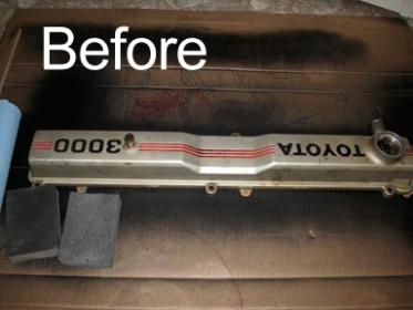

Default Valve Covers repainted
Just some pics, My heads taken forever they head to take fourteen thousands off and theyre still doing the valve job hopefully next weeend ill have everything back together all the parts are here and mostly clean but I thought since I had the extra time why not paint the VCs I used High temp paint to paint them, 500f and for the accents I used acrylic Ill keep everyone informed if it dosent last. Also some pics of injectors after clean Ill post more pics as I finish every thing up try to get some of block and deffintly head when I get it back.

Old 08-16-2009, 03:20 AM   #7
Kevin
Join Date: Apr 2009
Location: Ontario, Canada
Posts: 194
nice haha. i wish i wasnt lazy to paint.
Old 08-16-2009, 04:08 AM   #8
scaggsj
scaggsj's Avatar
Join Date: Aug 2009
Location: Florida
Posts: 87
I wouoldnt have paited them but the machine shops taking to long with my head and I had extra time. I got them both done now they look awsome. I cant wait to see them on the car with the intake blocking them lol.
