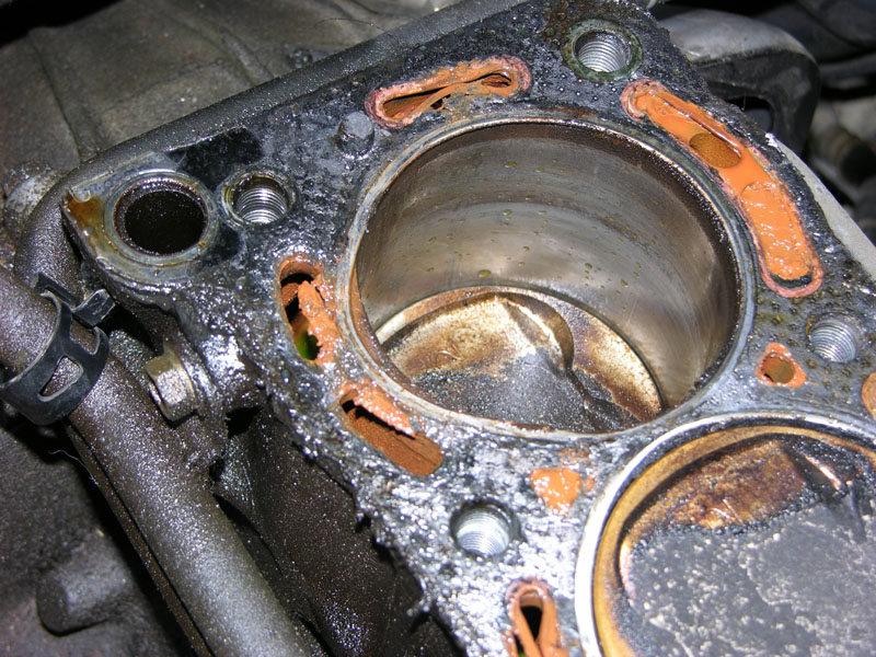

Originally Posted by oregonjoe View Post
Don't metal head gaskets require a perfect finish on both the block and head to seal correctly? I had my block out so I could have the deck shaved and the shop still would not recommend going to a metal head gasket. Seemed that over the years water/coollant eats away at ports so that even a good shave will not it get right.
before block prep
Attachment 2263
after block shave
Attachment 2264
Unless you going to remove the engine block grind the block deck to perfection - i'd go with a composite gasket. It will be much easier and last 20 years
