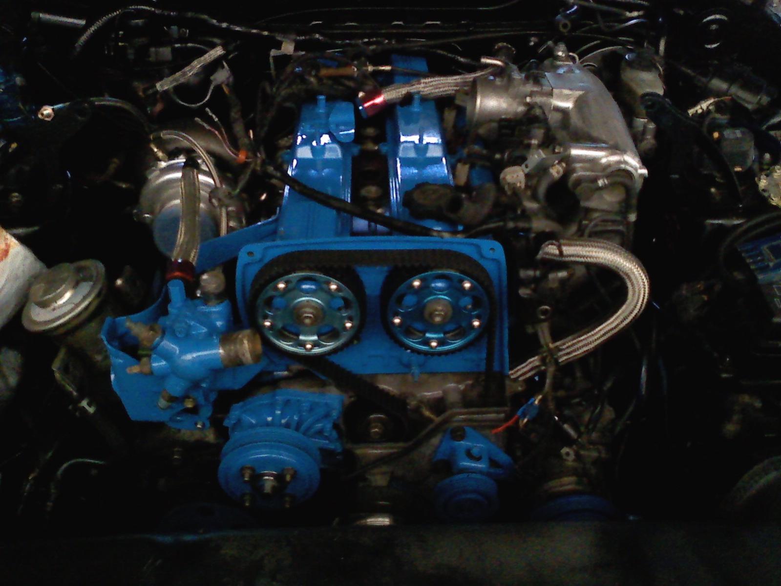

No offense to your post there.... but I strongly disagree ! If the block off plates are installed correctly with a coated cometic gasket. they will never leak. And there are 2 plates to install not just one. As far as the warm up or power at Wot, no problem when running stand alone fuel management. and if your exhaust is big enough, heating up is not an issue. If you convert your pulley fan to electric fan it will stay alot cooler. FMIC will help too.
You need to reread this whole thread... We were talking about the EGR actuator leaking... dunno how you got that actuator = block off. Again, no idea what the hell you're talking about with warm up and WOT... you're lost sir.
Oh, and electric fans don't cool the gasses IN the intake... sheesh. Sleeping at the wheel?
