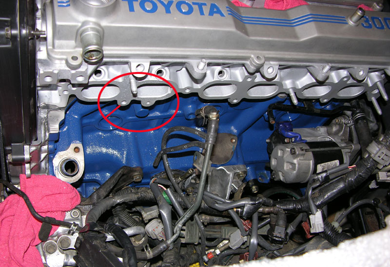

except a leak underneath the intake runner (that tiny nipple i was trying to find before. but it actually doesnt look like its coming from the hose. looks like coolant is leaking from where the intake runner and the engine head meet..... im so lost. this will be the 4 time taking everything apart. any ideas?

Old 01-12-2010, 02:16 AM   #185
The coolant channel passes through the runner's flange and into the head. If the gasket is damaged or poorly sealing it will leak.

Default Water Through Intake Runner
Yup - true as rain. That magic nipple under the intake runner feeds right through to the head and if the gasket is not right - will leak. I RTV every place where coolant can leak. .

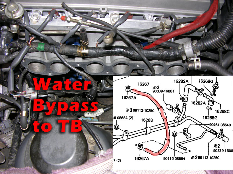

Also don't forget about the coolant bypass that goes up to the throttle body as well
RTV the Intake runner on both sides where the collant passes through, Rtv all coolant hoses
No leaks yet,
