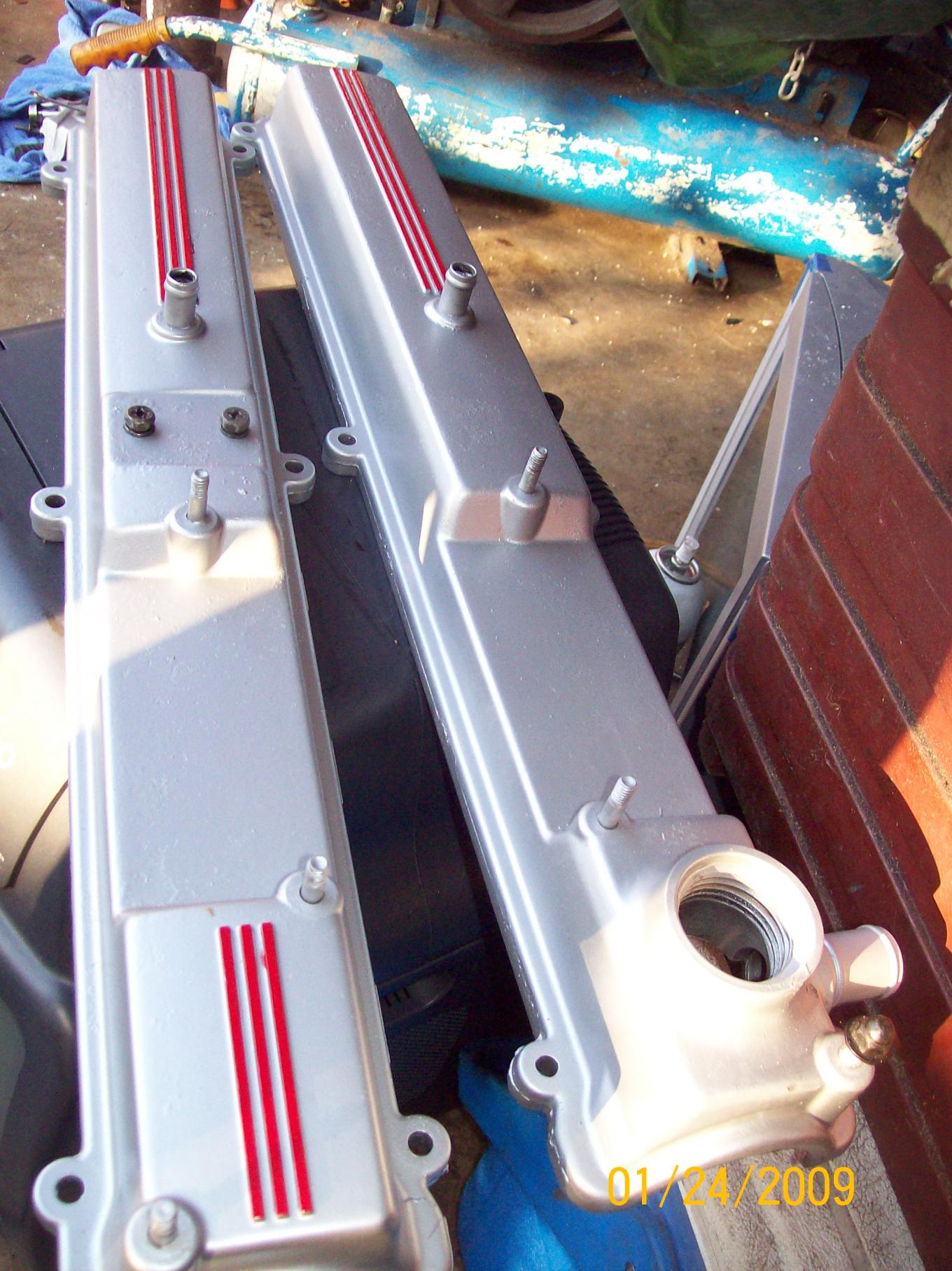

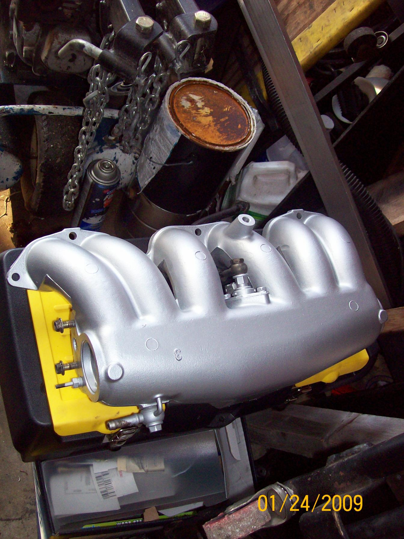

i was wanting to paint mine too but no creativity, can you show a pic of urs? lol. so my car has an aem fuel rail..... diddnt know aem made fuel rails for mk3s. hmm. so ill just pull them off BUT do my cams have to come out too? lol heres another pics homes.

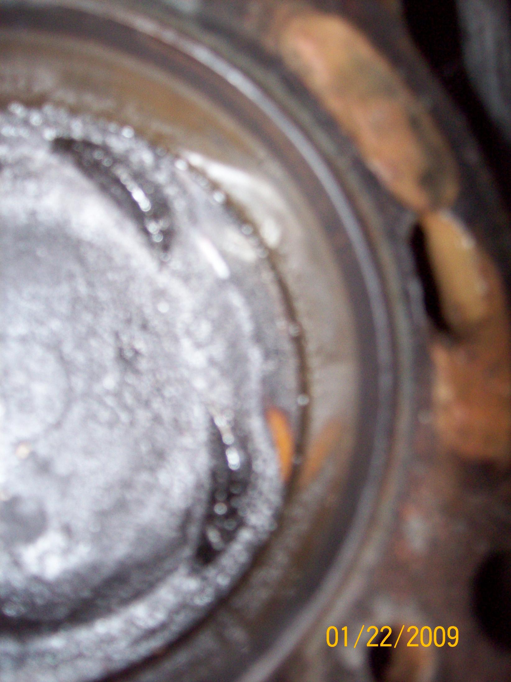

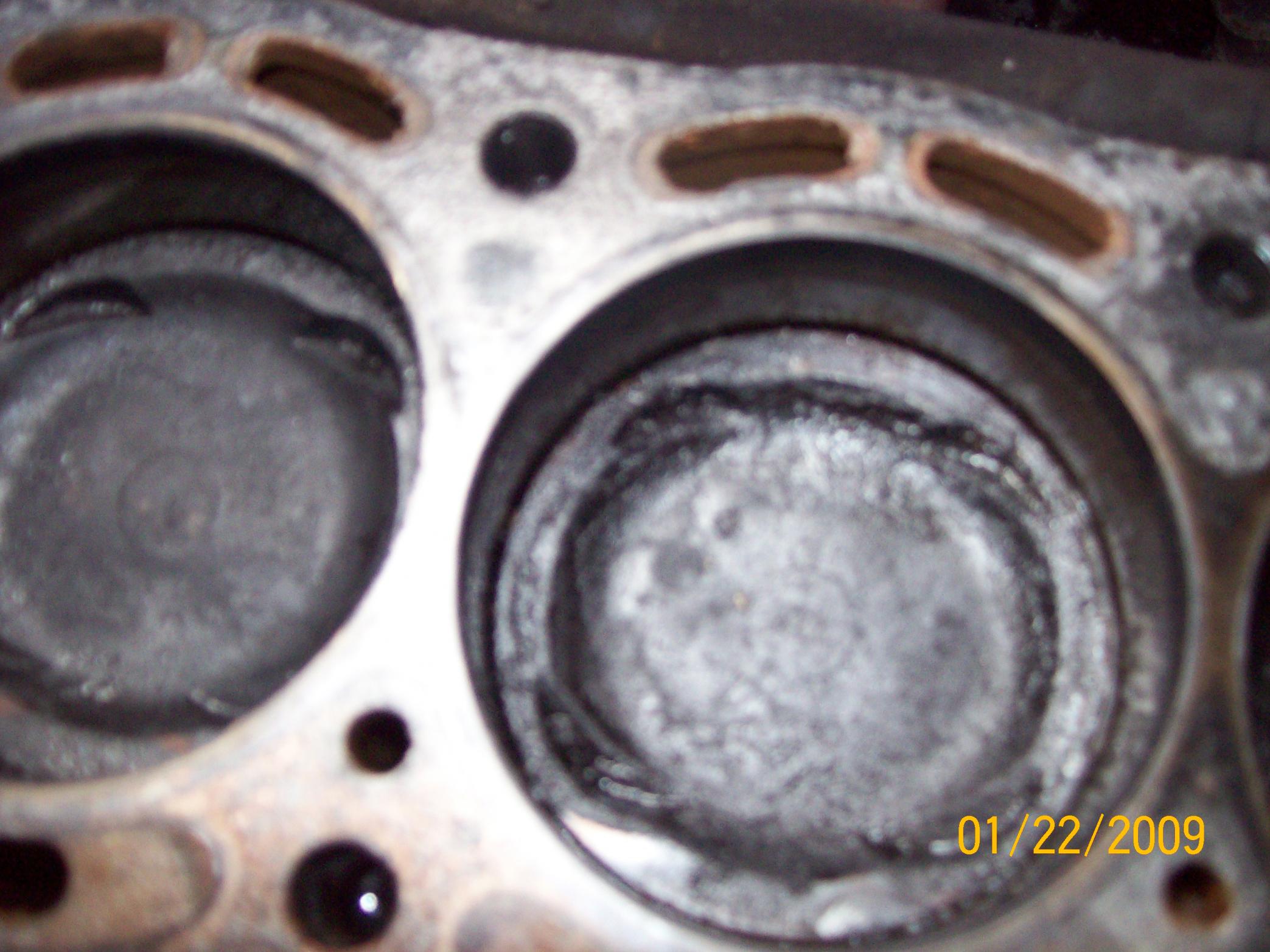

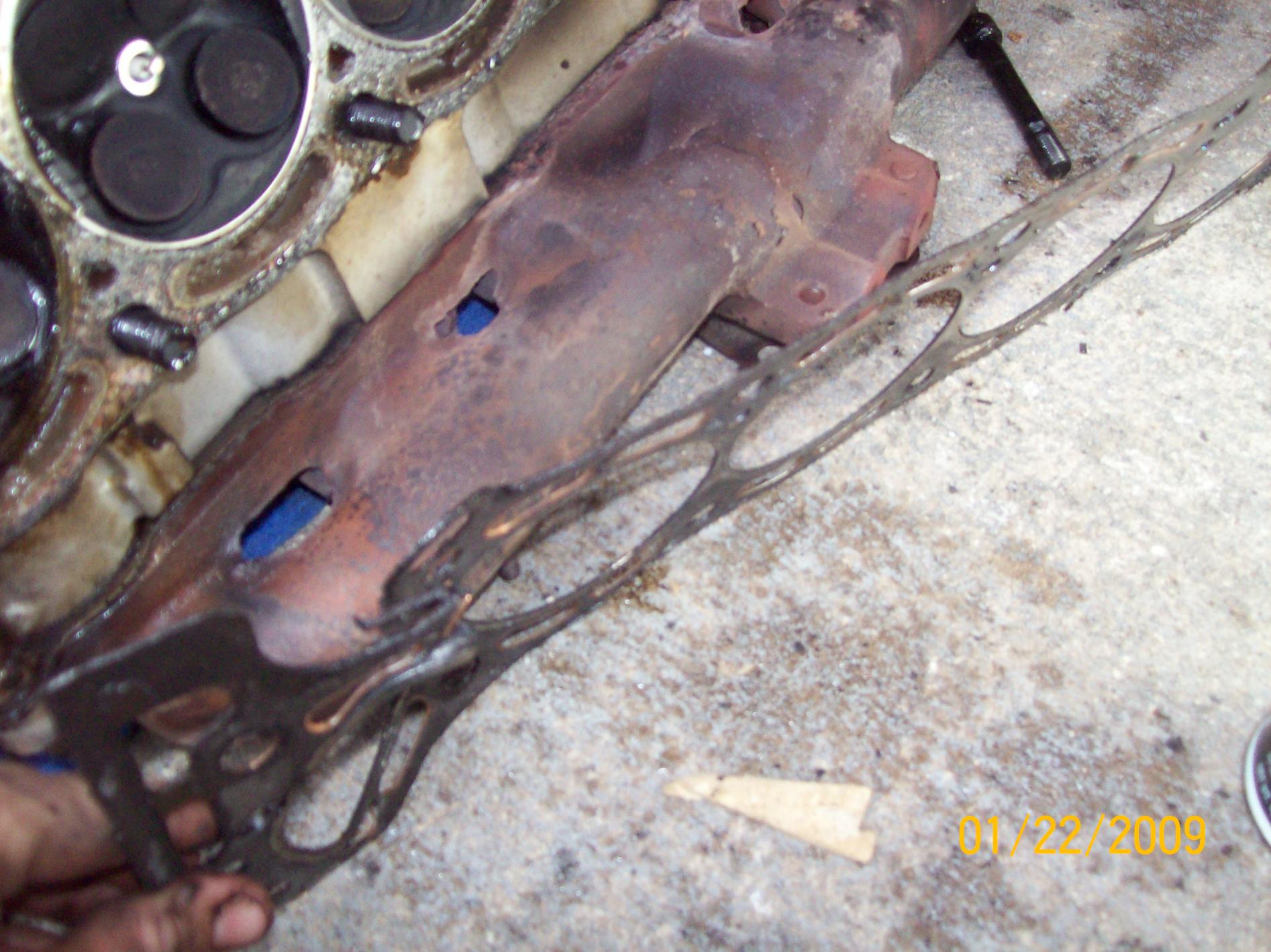

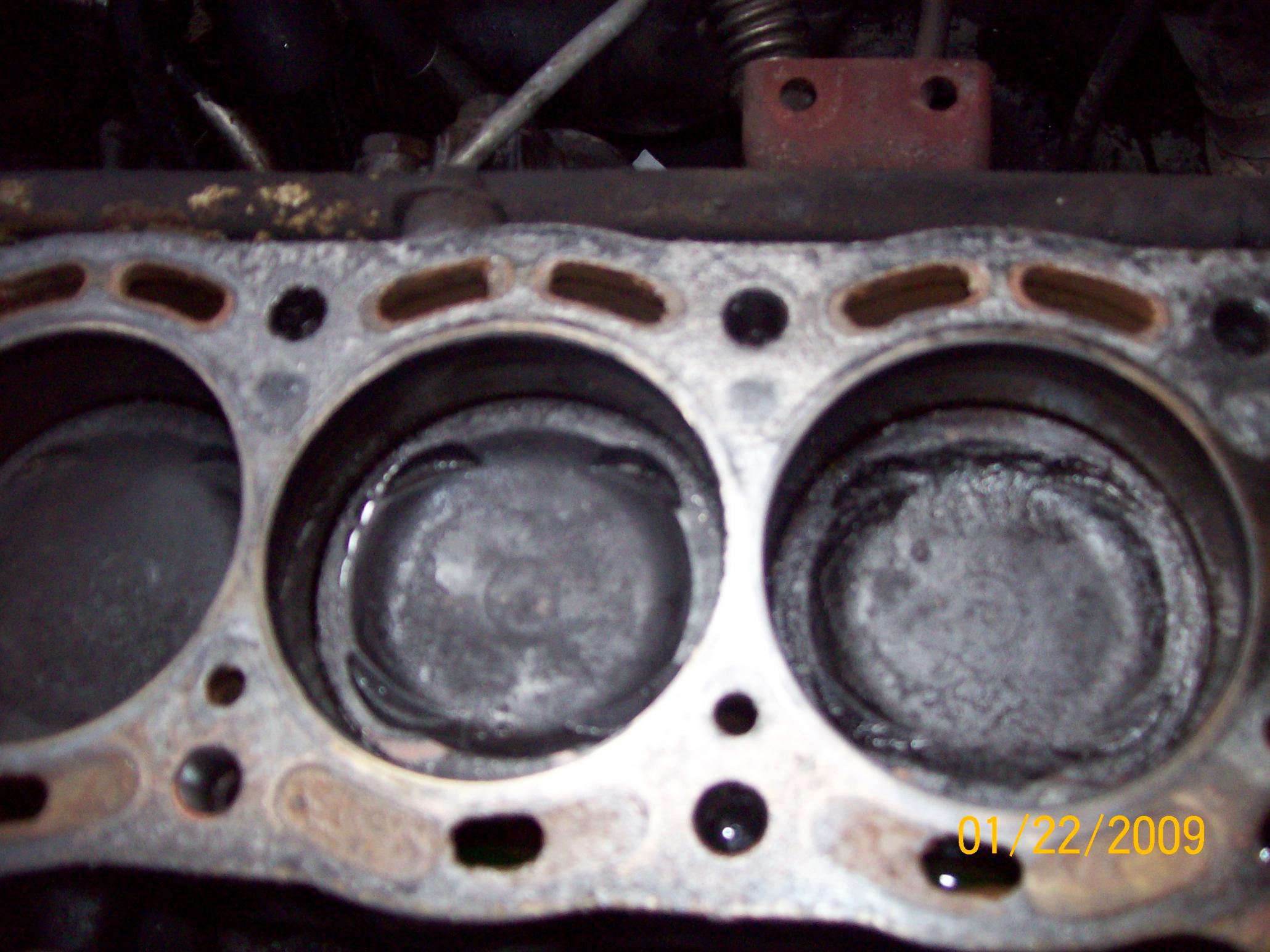

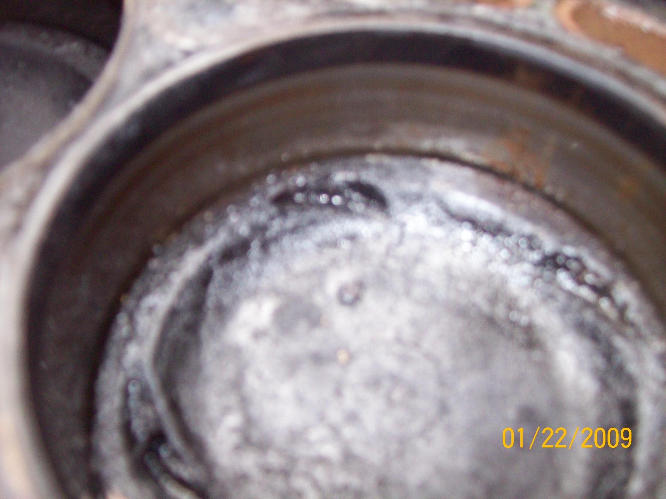

I got it, thanks to you all the head is off here is the pics.

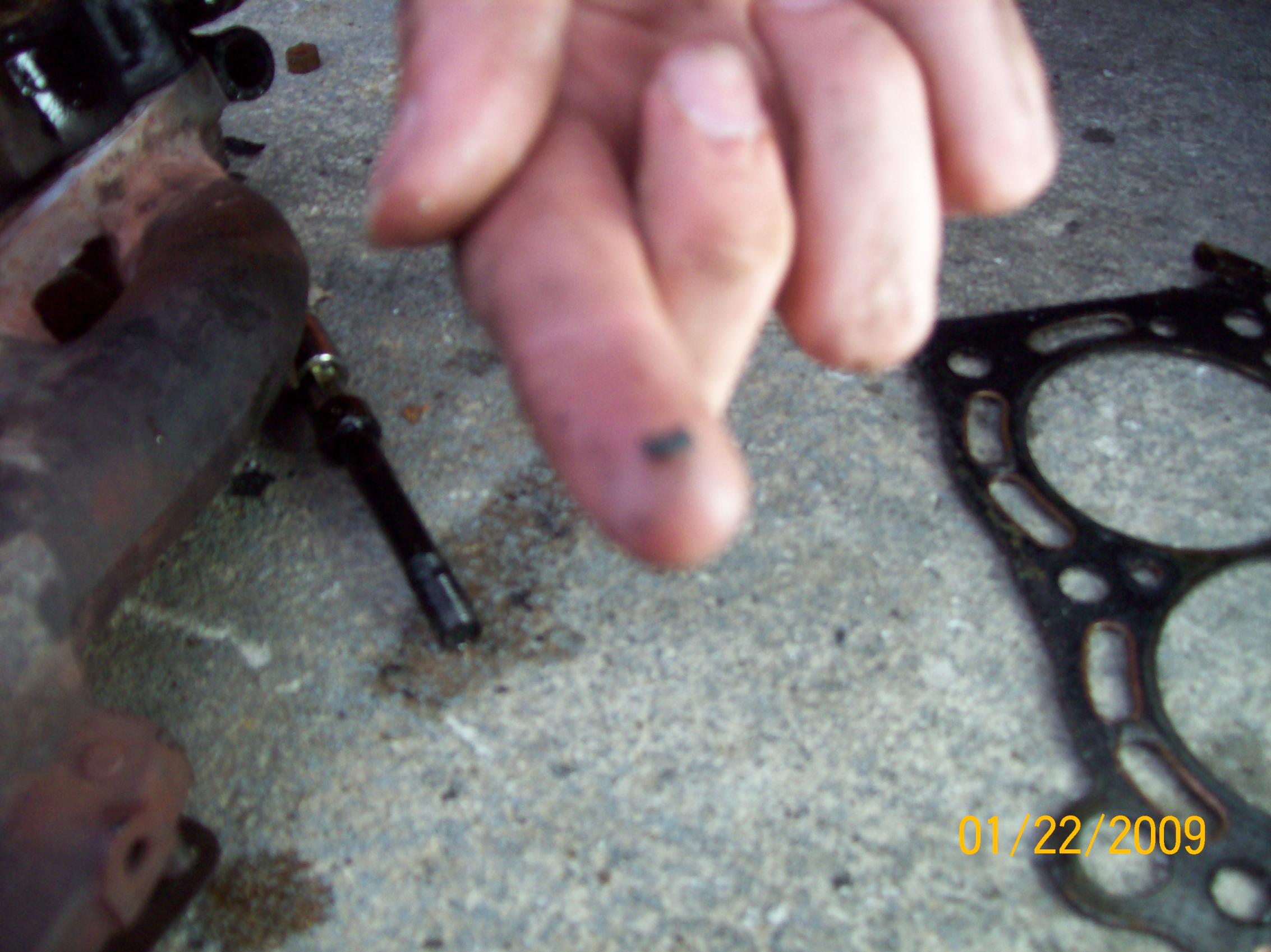

Oh, he lied about the mhg, the arp studs and i got the little pieace of heli coil fucking everything up so now its time to send shit off the the machine shopppp
Oh and can someone give here opion if my pistion is fucked? It looked terrrible, BUT 78% of it was build up only on that one cynlender with the tap. you can see it before and after i clean it up, and were it was hitting the little pieace of metal and were the metal was engraved in the headlol.
Attachment 2606
Attachment 2607
Attachment 2608
Attachment 2609

Is pistion salvagable? What do you guys think...

what do you thinkkkkkkkkkkkkkkk?

Sorry, had to go the other night.
Well first job on the list is get down the guy who sold it to you's house with a can of gas, a box of matches & your negotiating hat on. Get a few hundred $ off him for the aggro he's caused & for lying. Then get everything cleaned up & see how bad it really is.
If the bore & side of the piston aren't damaged then I'd suggest you could get away with it for now, provided the rest of the motor's sweet for a few thousand miles.
If it's generally pretty worn looking though (any smoke? what was your hot oil pressure like at idle, if you recall?) then I'd budget for a full on rebuild or engine swap. To my eye those bores look pretty worn but the pics weren't the best for telling that.
To be honest the best thing to do for now is to clean everything up as best you can, take some more pics including some of all the bores if you can get them to go right (mine wouldn't go in focus 'cause of the shine!) and go from there.
