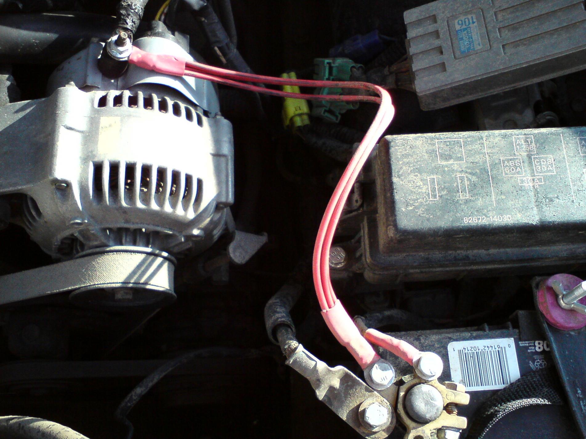

Here you go.
Really easy to do, like 3 min job.
Need 2 ends that can be crimped and some wires. I used 3 wires (don't remember what gauge) because I didn't have enough gauge wire for the power from alternator to battery. Better than have a little too much wiring than too little and causing heat issues I guess.

Ohhhhh okay i get ya, looks simple, except my issue here is not that cable, you see the one in the back of the alt. thats 3 wires, yellow white and another
thats what snapped on mine, but im going to try this method. Thanks very much
I have no idea what those wires are for.. are they for powering accessories? If they are, then what I did will not work.
I only did what I did because my alternator wouldn't charge my battery.

You should see around 13.5v to 14.4v while the engine is running; Measure it at the battery and at the alt and reference ground at both the battery and the at the chassis. A low reading at the battery but an acceptable reading at the alternator indicates a bad battery wire or fusible link.
Mark, at least add a fusible link to that wire... VERY bad idea just running it straight... your problem may only be that you need to replace the 100A fusible link as it is, but if you want to keep the added wiring add a 100A fusible link to it.

Yea with the wires there I'm seeing about 14.2V, without it I only see like 12V which to me indicated a wiring issue.
I know I should've checked for fuses.. but for some reason, I don't have any memory inspecting the 100A fuse. lol I should go do that.

The fusible link seems to be the most common cause of voltage drop across the alt to battery line... more so than the barttery wire. This is more common in earlier MKIIIs as they use a fusible link wire as opposed to the sealed fusible link used in later models... fusible link wires are more prone to degradation over time.
BTW, you can switch the wire type out for a sealed link.
Old 03-06-2010, 09:43 PM   #18
I should add that if you use the battery's negative terminal for your ground and measure a proper voltage at the alternator's output lug but the voltage at the battery is very low you needn't bother with the other wiring on the alternator, just follow the wiring from the alternator's lug to the battery.
You can also to a voltage drop test (negative test lead to the alt's lug and positive test lead to the battery's positive terminal), the reading should be very low, more than half a volt and you need to track the drop using the same methodology until you find the cause; You can do this test across just the fusible link to see if the fusible link is the culprit, but you have to pull the section it's mounted in out of the fuse box housing so I usually test the drop across the whole thing first.
