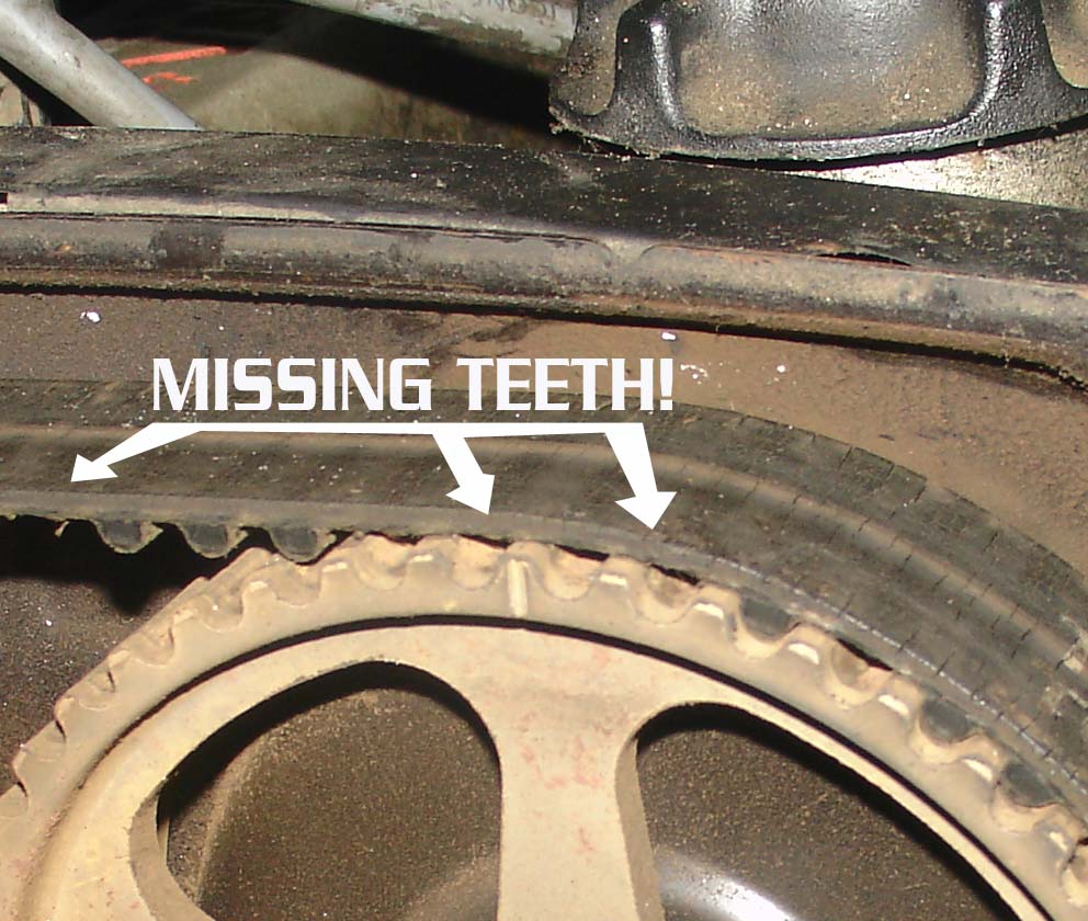

UPDATE> I have a found the problem the timing belt jumped! The marks do not line up as they should crank pulley to cams at TDC
I have steady cracking in the timing belt but it is intact so I am curious as to how it could have jumped like that. If the #1 piston is at top and the cams line up at 12:00 noon with the marks on the cams it then it can't be 180 degrees out correct?
Makes sense that the Timing belt skipped or jumped. Got the radiator out and I guess I will get in there and get that pull;ey off. I better go out with a flashlight and dose it with PB Blaster. Here are some pics.
