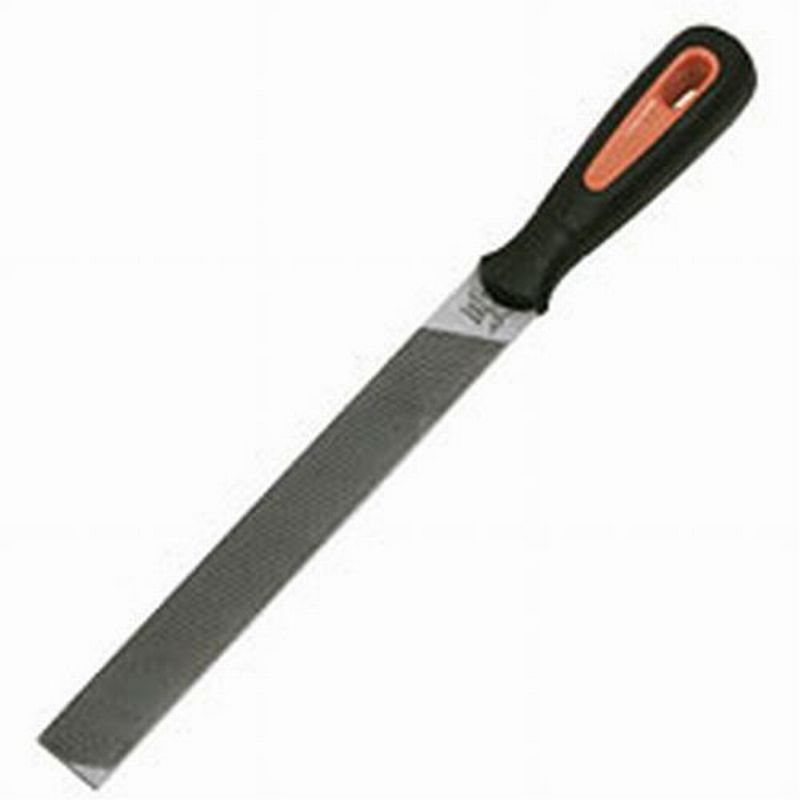

Seriously though. Blindly attacking it with a file or angle grinder is a HORRIBLE idea.... a belt sander would at least assure you of a more even surface. I'd attack it with a lapping plate with a piece of 320 sandpaper laminated to it and then some diamond lapping compound of decreasing grits to take it down (In fact I've had to do so in the past).

Does that surface seal combustion, coolant or oil? If so, than proceed with care. Otherwise this should work!

That aperture between the block and the rear cam cover leads to a drain hole into the sump, as you will see if you put the gasket on top of the block there are two oil gallery’s that line up at the front. As you are only removing .013 thou and the cam cover is only cast ally, I would do as cre suggested.
