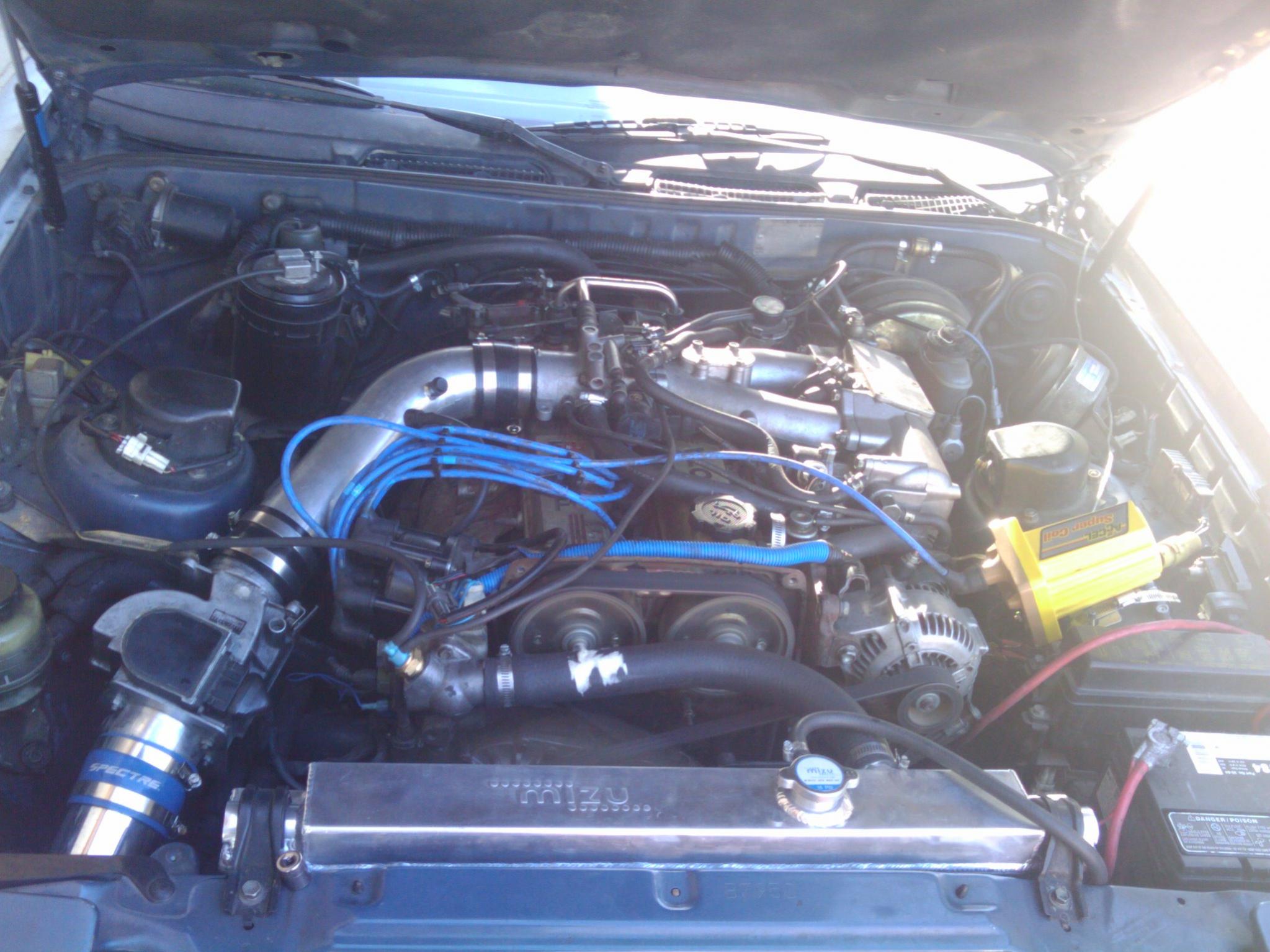

86.5 7MGE
86.5 7MGE's Avatar
Join Date: May 2009
Location: Denver
Posts: 104
86.5 7MGE is on a distinguished road
Default Suggestion
What I did was just use some after-market piping from a different car and fabricated my own it looks nice and Cre has seen my work; it's CAI and I have my cone filter behind my bumper with a shield on it to protect from direct splash or rain; now just have to fabricate a front diffuser to better protect it from puddles and find a piece of piping to fit in to replace my big sensor box.
Name:	2010-05-26 16.29.37.jpg

Cold Air Intake
yeah im gonna start fabricating mine shortly
