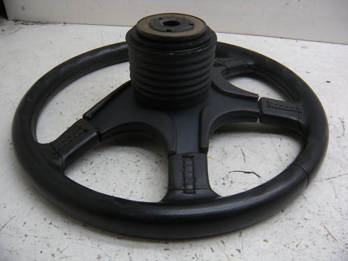

Hey, I need to know if this Momo steering wheel is really OEM and if it will fit my 87 mk3 without an adapter.

IIRC, TRD sold a momo for the JZA70 chassis... If that is accurate then no, it won't fit, not without some work. It would probably fit a 89" with little effort though. You would also have to figure out a way of replacing the cruise control controls.... If you're keeping the cruise control.
