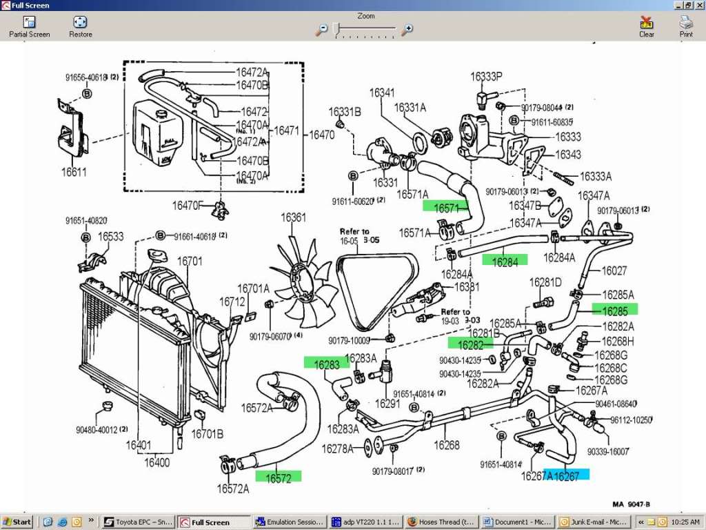

All of the hoses. Make sure the system is completely purged of air, the fan clutch is good, the shroud is present, check for blockage between the radiator and a/c condenser also if front of the condenser. The 7MGTE cooling system is complex and has many points of potential failure but in good condition it is capable of handling some serious heat.
ID:	4143   Click image for larger version
