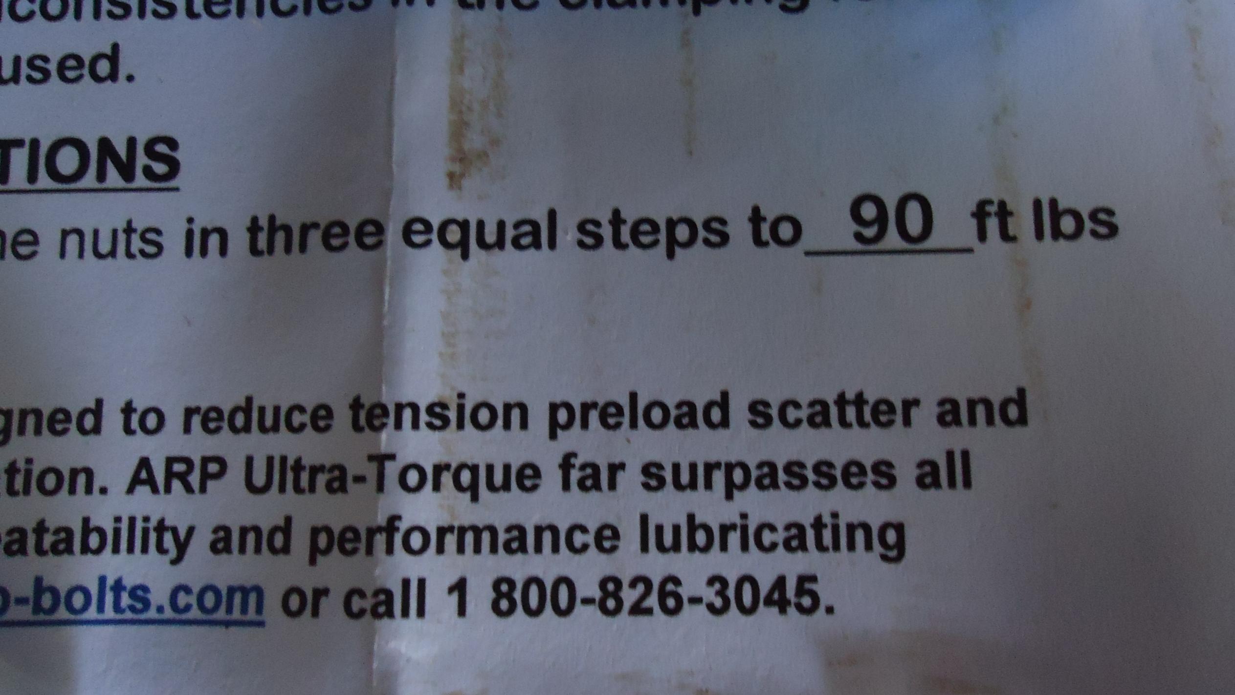

7mgte ARP studs:
not sure when they were manufactured but i just used them in a 5mge a week ago. i only went 80 lbs.
