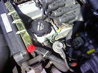

Hi , Did you get your car going ? I forgot to mention there is a ground strap connected to the plate holding the ignition coils . I modified mine by extending and connecting directly to the inlet manifold . The forum would be pleased to know what success you had .
