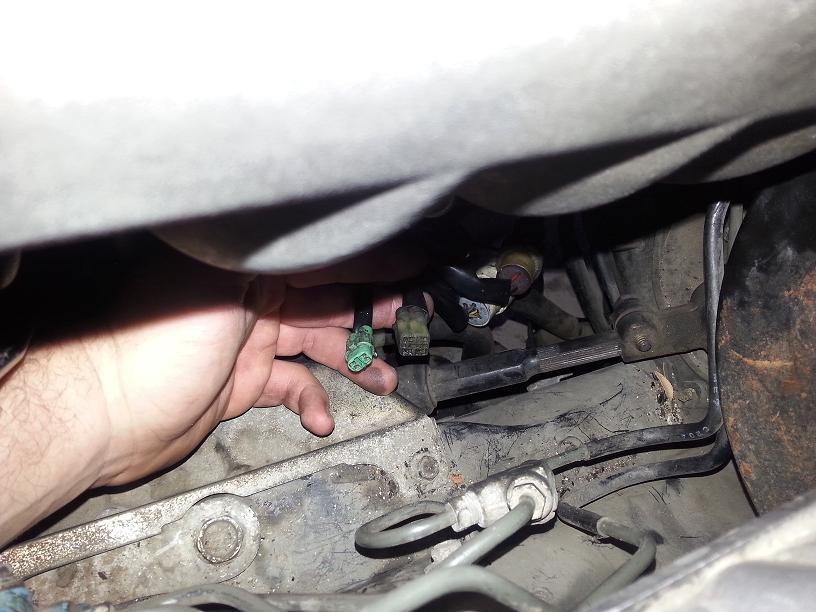

I've got one more thing I've been concerned about since putting the car back together. I have a picture here showing two plugs that I haven't been able to locate.. While I was tearing the car apart I forgot to label these and it's been making me scratch my head ever since.
I'm not sure if these are meant to actually connect to anything or not.
please let me know.

I think extra connectors under the intake manifold is normal, they could be for the different transmission options/abs/etc. I don't immediately recognize those ones in particular.
