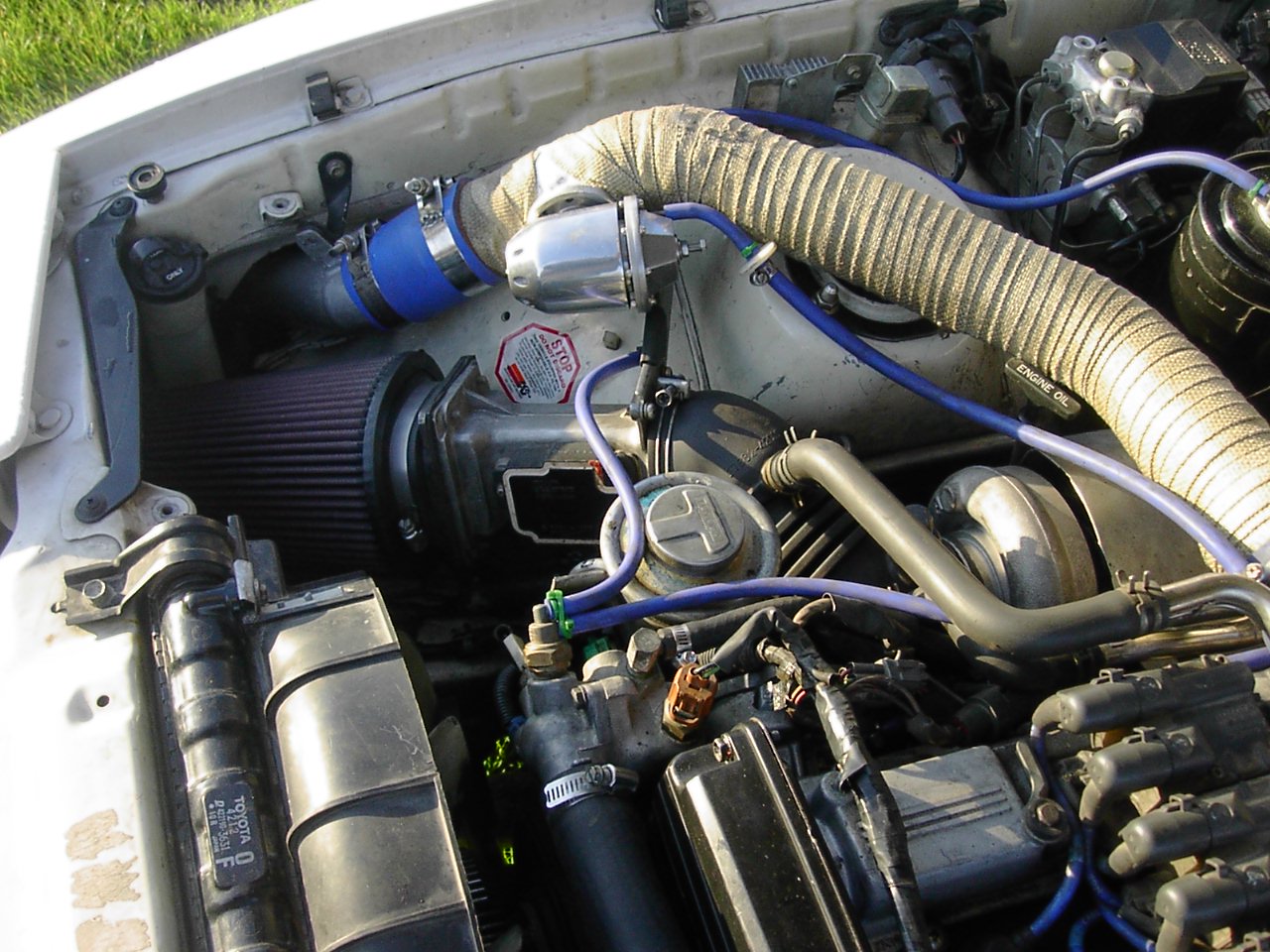

here are some of mine. not close but ok..
ID:	74   Click image for larger version
