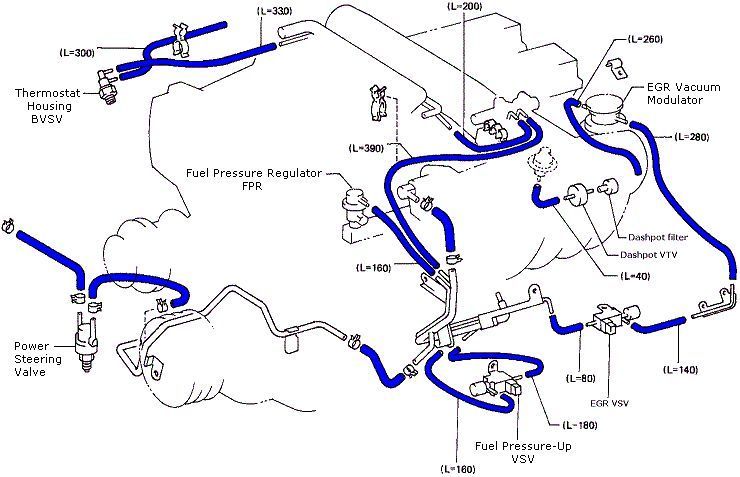

Default vac lines
i dont know. but..merry xmas
