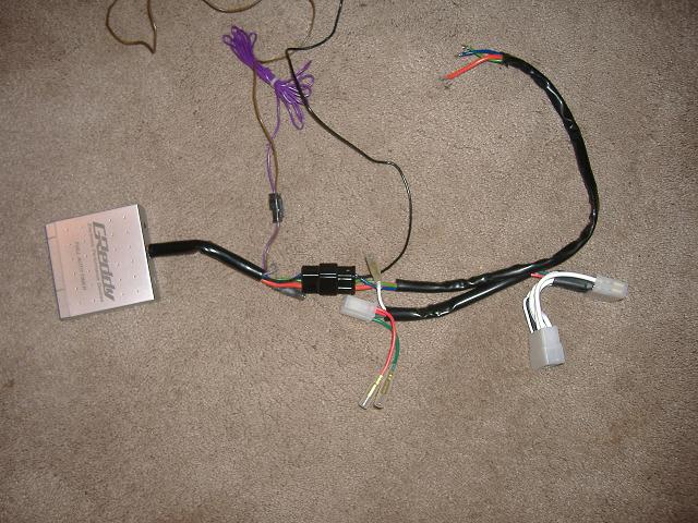

Alright so I have the Greddy Full Auto Timer for my 88 supra, and I also have the wiring harness for it. Is this an easy install? Do you know of any tutorials online that I couldnt find? Any help on this would be appreciated.
Thanks Jaymes |

I dont understand how this hooks up. If I am picturing it right, the harness (shown in white) is supposed to attatch to the G.F.A.T.T. in place of the other wiring harness? I have never done this before, and Im not sure I was sent the right harness..because the harness doesnt fit the factory outlet. Here are some pics..

I would say call greddy up and get the intsruction manual. Or try to find it online somewhere.

Looks like you bought it used without the papers.
As I thought most manufacturers supply support documents online. Yours is here. http://www.greddy.com/tech/FATURBO_TIMER.pdf |

well that looks really odd in my opinion
it looks like you have a harness too many if it was me, i would imagine that the end of the black harness that plugs into the turbo timer would wire into the wires coming off the ignition harness the green red n white the ignition harness should plug between the big plug that plugs onto the ign barrell that's how it's supposed to work, you can get the wiring colour instructions from the pdf that was posted GL ![]()

If its a manual trans supra, Im pretty sure theres something you have to solder to the ebrake wiring so it shuts the car off if the ebrake is released with the ignition off and the timer counting down.
