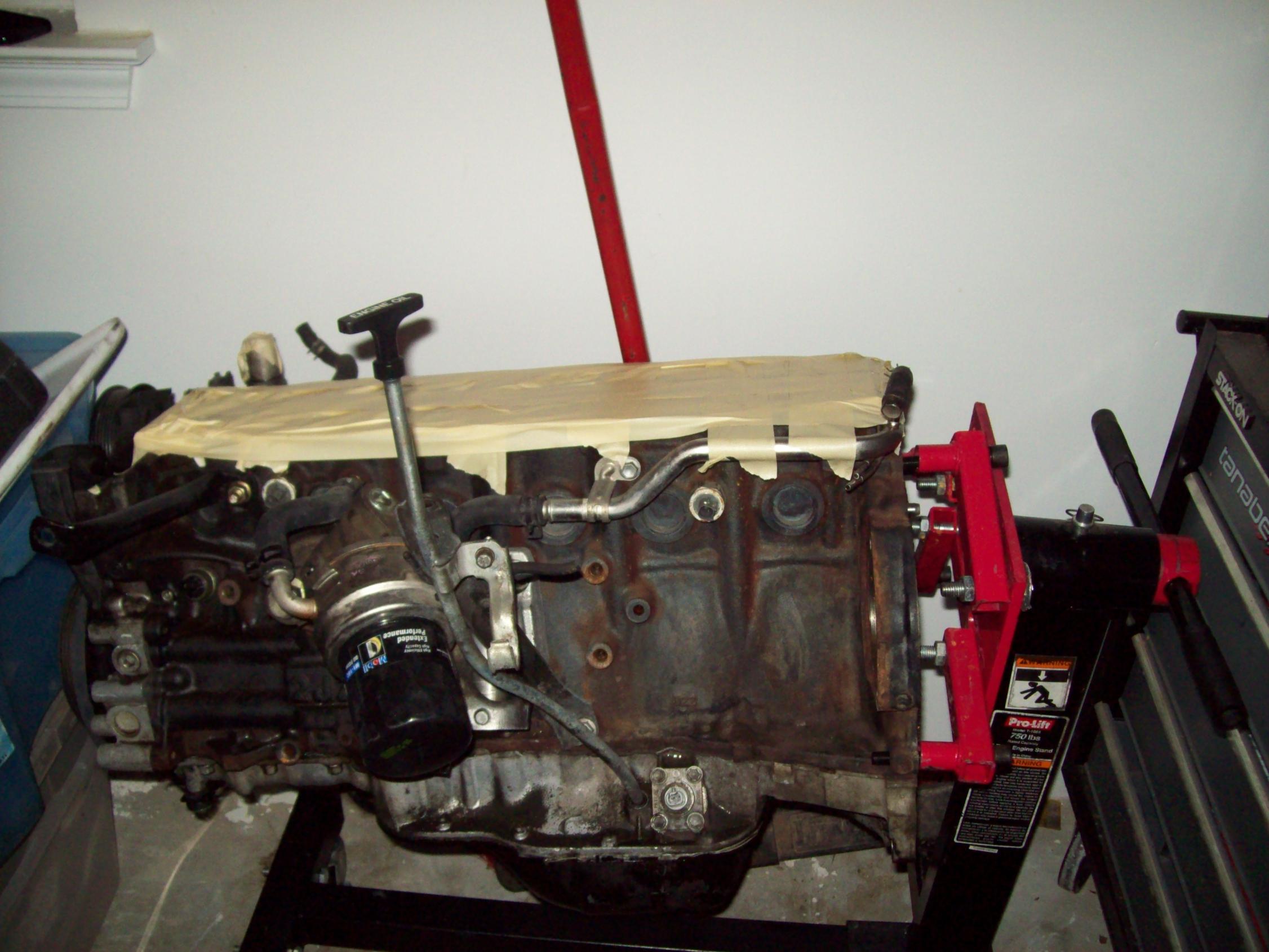

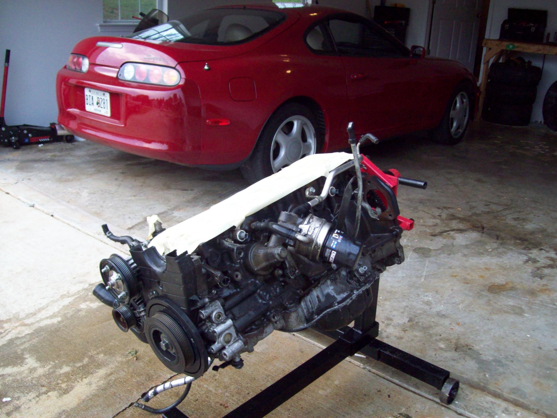

sorry its been so long since i've posted been working on the bike taking care of kids the whole nine yards. but we did figure out the problem! ready for it....the rings on number six & one are shot and it has a blown head gasket major bummer! enjoy some photos one of my sons were out there to help but wasnt tall enough to reach the tranny bolts hahaha so he just ate a few shop rags

Thanks for posting back. Why were the bad rings limiting your rpm? Was it smoking at all (via the exhaust)? Are you sure this is the (only) problem?
