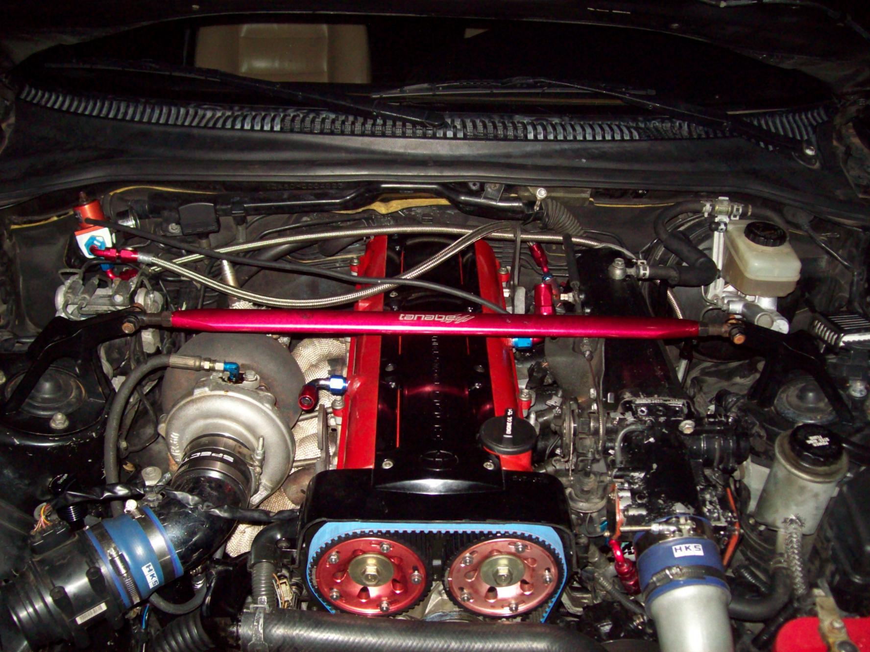

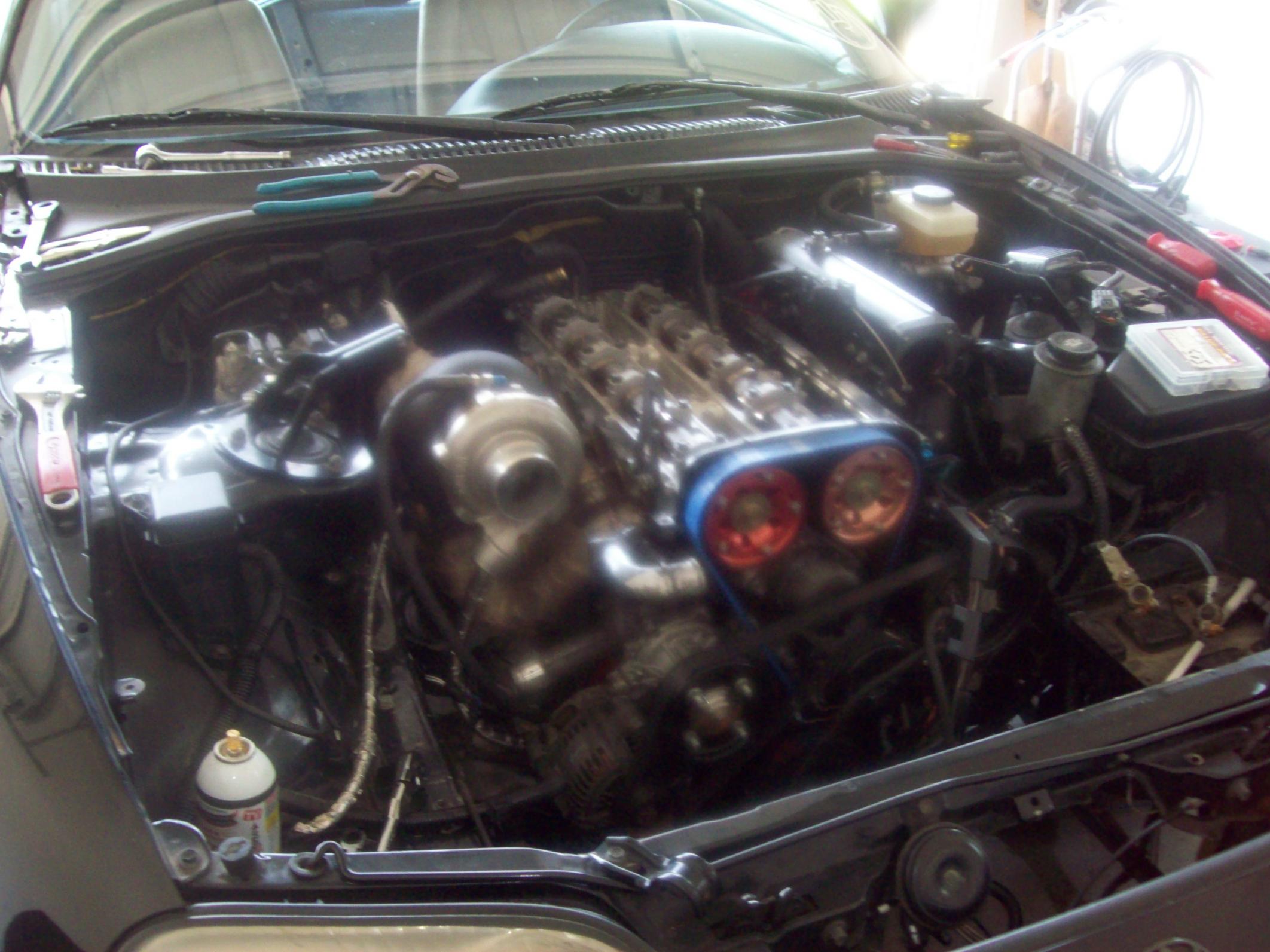

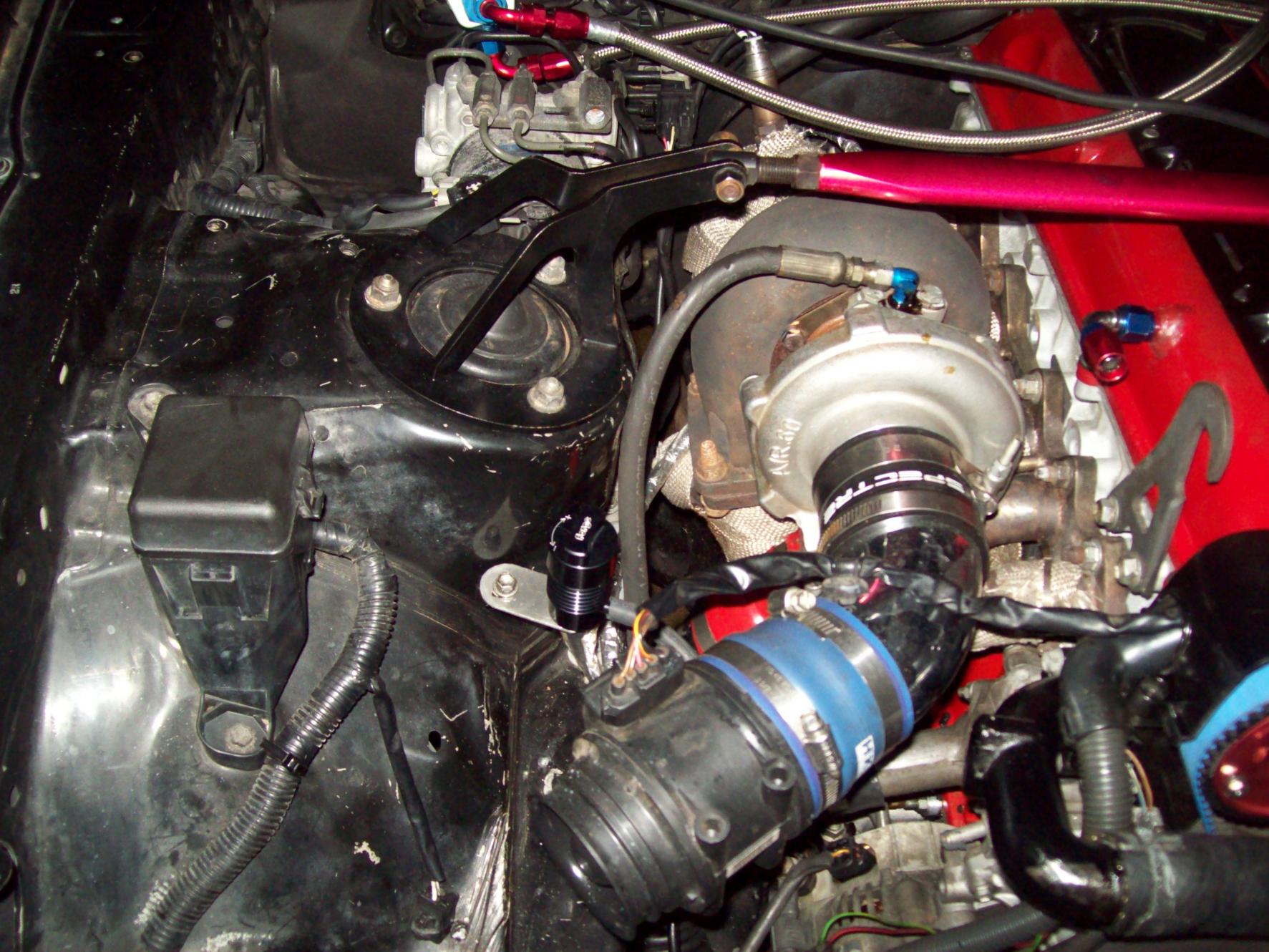

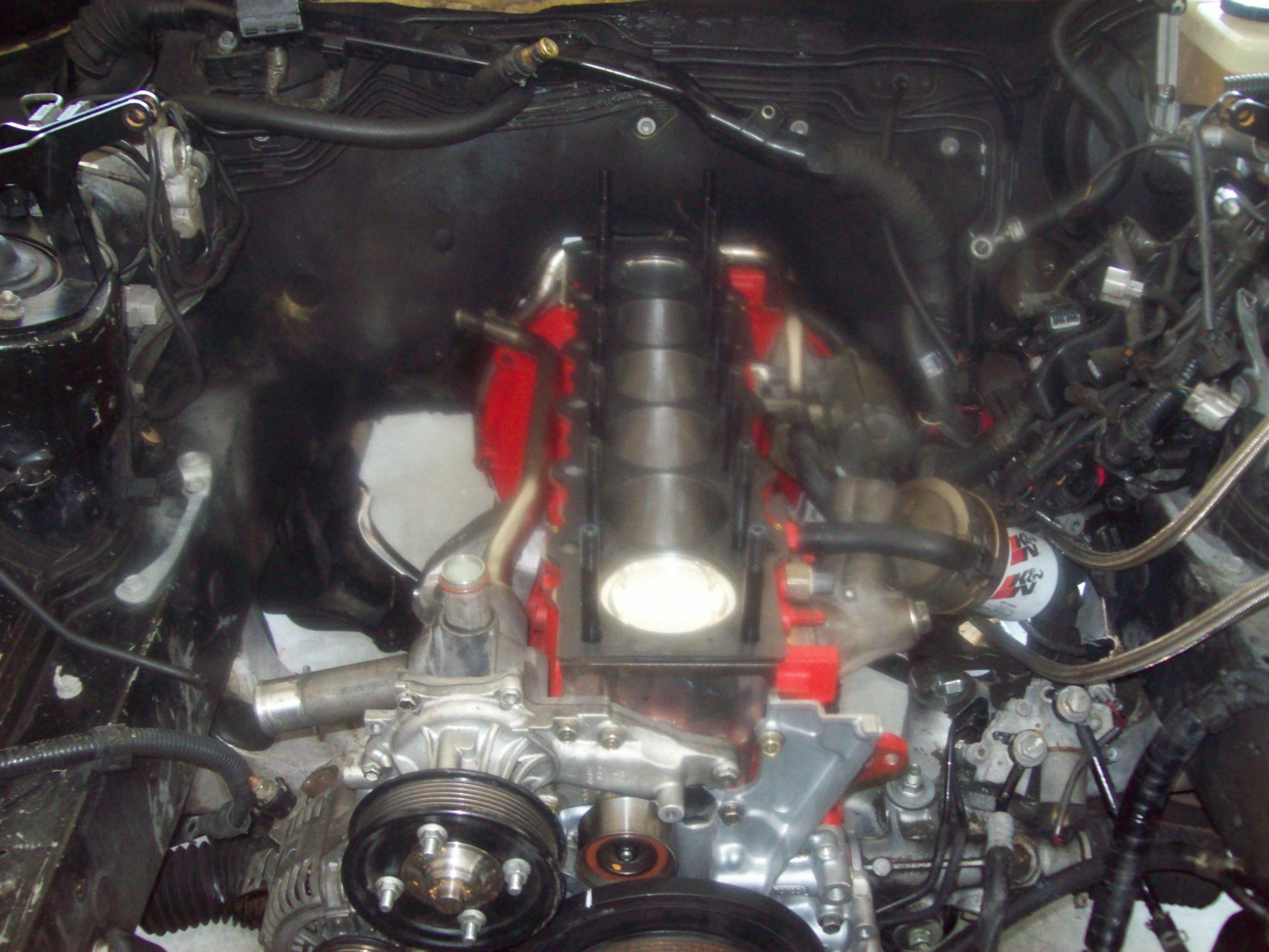

heres some photos of the build
ID:	3250   Click image for larger version
ID:	3251   Click image for larger version
ID:	3252   Click image for larger version
ID:	3253   Click image for larger version

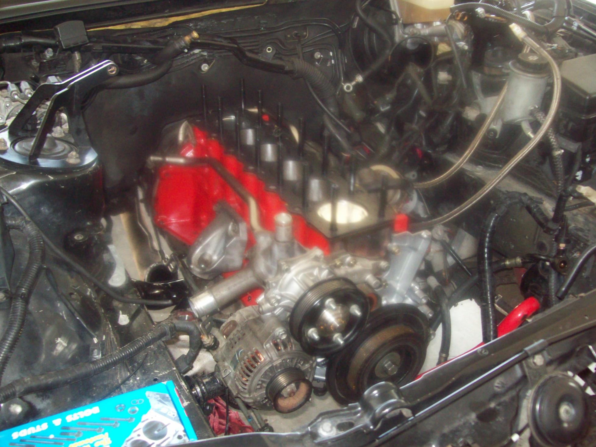

heres some more
ID:	3255   Click image for larger version
ID:	3256   Click image for larger version
