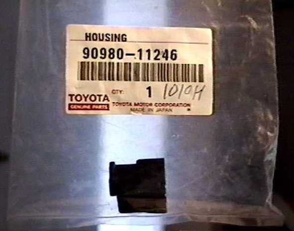

The street puts more load on the engine, which in turn generates more heat. More vibration could be a factor too. Either way, with new coilpack connectors and new coils I'd bet you'll be fine.
http://mkiv.com/techarticles/parts/c...ess/index.html
90980-11246 Coil Pack Connector
82998-12440 Repair Terminal
http://www.suprastore.com/tosucopaco19.html
