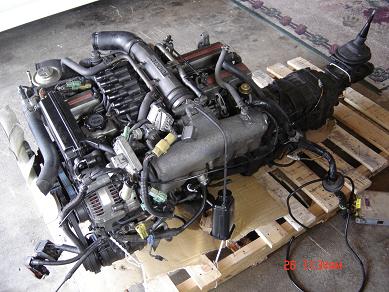

here it is

Looks real clean, Im glad you got it.

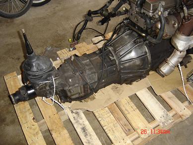

and you got the tranny, good deal. when i got mine, the fan had already broken a blade... your lucky

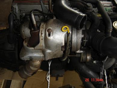

the only problem i see is that the power steering pump is bent and the exhaust bolts are stripped almost to a circle

iirc exhaust has studs, not bolts

If the 3 nuts holding the downpipe onto the O2 housing are stripped to a circle like you said (you have to be a real dummy to do that, not saying you, but the people that shipped it to you) then take off the 4 nuts holding the O2 housing to the turbine housing. They are 14mm and use some penetrating oil on them. Work them back and forth so you don't snap the studs, because they will be partly seized, I can bet you that.
