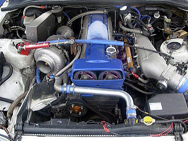

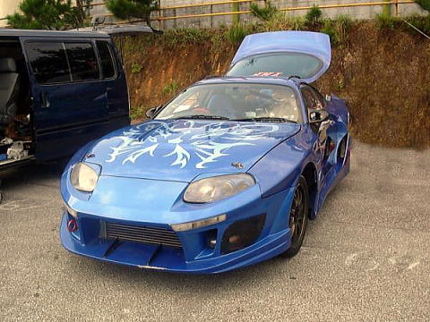

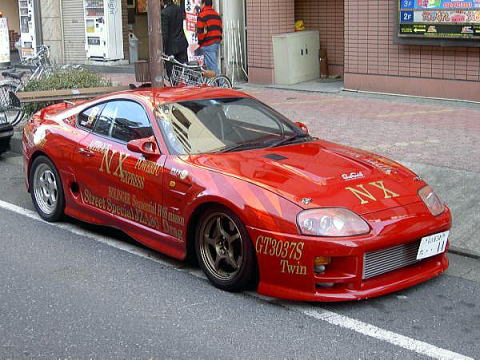

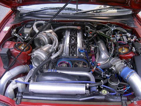

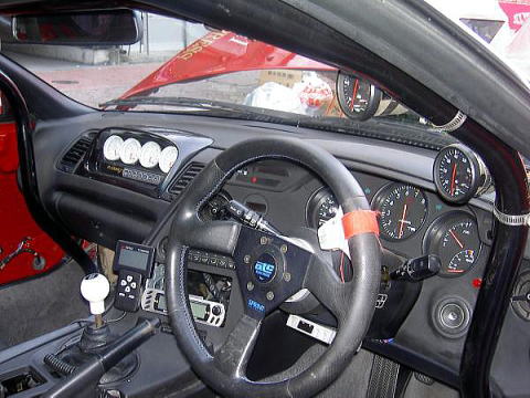

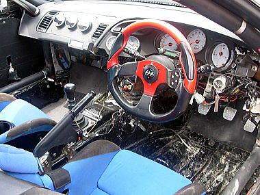

These two supras are for sale in japan currently, the blue one is bored up to 3.2 the red one is bored out to 3.1. both are over 1000 bhp
